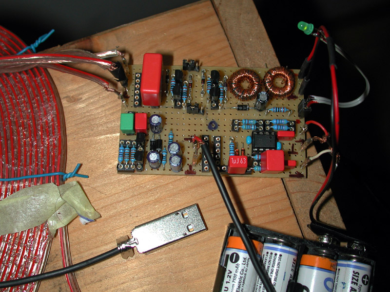

                            • USB VLF Controller Pics
                              This is the running USB VLF Controller. Actually operated with 4 x Ni-MH battery pack.
Name:	USB VLF-OSC-DetectorController-prototype-01.jpg
                              (It's the center-tapped TX coil configuration. The lower section (n-mosfets) of the TX oscillator isn't working - the jumpers aren't shorted. )

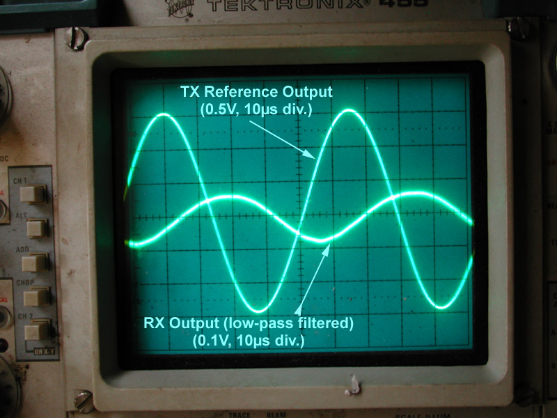

                              This is the scope output of the controller outputs:
Name:	USB VLF-OSC-DetectorController-prototype-Scope-02.jpg
                              (I have just filtered the output of the RX amplifier by connecting a parallel capacitor to the 1 kOhm feedback resistor in the amplifier. ) .
                              Cheers,
                              Aziz
