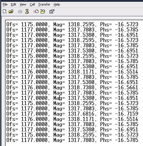

                        • #87
                          The first DSP Lock-In-Amp test - sine 12.5 kHz
                          Offset and Magnitude in samples
                          Angle in Deg
                          Rx-Tx direct connected, calculation - 300 frames per sec
                          • #88
                            Angle in Deg
                            Hi TheWizard,
                            nice, really very nice. So you can sweep the coil at 1 m/s and you will have every 3.3 mm a measurement. This is very good!
                            You have probably small window/frame size. How much? And how much is your sampling rate and bit depth (12)?
                            Your offset, is this the DC offset of the A/D converter?
                            Now I am looking forward to your progress.
                            Aziz
                            • #89
                              Your offset looks like the sampling offset due to latency time of TX and RX.
                              So it can't be a DC offset.
                              • #90
                                This days I will investigate results... I need to write Win Exe for debug datas from DSP
                                ADC is 12 bits 0..4095, sample rate 100k, Vref 3.3v
                                DAC is R-2R, for 12.5kHz sine TX - 16 steps, 5 bits, filter is only one capacitor
                                DC offset must be ~2048(I have not AMP driver to correct DC for 1/2 Vref), but in my calculations DC offet is without meaning... in picture Ofs is calculated DC offset (in ADC steps)
                                window for 12.5 kHz sine is 8 samples per wave
                                and this is not the best times and results, this is only FIRST test
                                Next I will try to create PWM sine wave for coil and add some drivers and LP filters...
