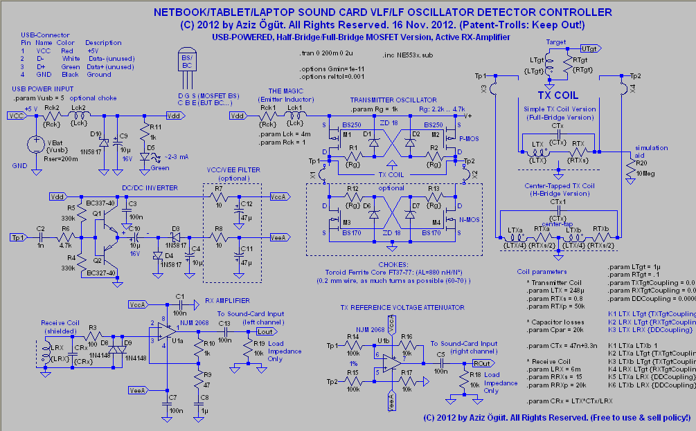

              Hi all,
              I realize, that an universal circuit is the best option for the USB version. So you can either use a center-tapped or a simple TX coil (or even commercial coils ).
              Its in full implementation a full-bridge cross-coupled mosfet LC oscillator (for simple coils). If you leave the lower part of the transmitter unpopulated (n-mosfets parts) its a half-bridge for center-tapped TX coils (as usual).
              Unfortunately, the full-bridge version requires a difference amplifier so I have to use a dual op-amp finally (NE5532/NJM2068 ). Anyway, the TX coil voltage is attenuated resistive in a difference amplifier (making the TX reference). And we have an active RX amplifier for more sensitivity and depth (therefore one dual op-amp required).
              BTW, the full-bridge version makes very low inductivity TX coils possible (at the expense of more power consumption).
              I'll build the full implementation and see what happens. If everything works as expected, then you can get the schematics (nothing to keep it secret - a very trivial work). A PCB version would make sense too.
              Cheers,
              Aziz
              PS: Only the power supply of USB port is required. D+/D- not connected.
              • Preliminary USB VLF OSC Detector Controller Schematics
                Hi all,
                this is the first version of the USB VLF OSC Detector Controller (subject to change). You know, I'm quite lazy and it will take some time until I can build the first prototype. But you will get the schematics first.
                I'll put the LTspice files for your convenience too (including simple TX coil and center-tapped TX coil configuration).
                This is the schematics:
                (Yes, that's it!)
                This is the LTspice file:
                USB-VLF-OSC-Detector-Controller.zip
                Enjoy and Cheers,
                Aziz

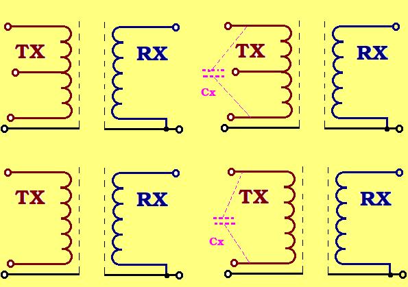

                    Aziz, what are preferred data of those coil? Do you chose DD shape?
                      WM6, any induction balance (IB) VLF coil, which meets the following criterias:
                      Simple TX coil:
                      Extra shielding wire required (not single ended TX coil, shielding not connected to one end of the TX coil)
                      Either parallel capacitor connected (in the coil) or left free (TX tune capacitor in the controller box)
                      Should not have a damping resistor (not a PI coil)
                      Center-tapped TX coil:
                      Shield on center-tap or additional wire for shielding
                      TX inductivity and resistance can be any. We can make it working. The LC oscillator is flexible.
                      RX coil can be any (inductivity & resistance). Preferably single ended.
                      I think that not every commercial coil is convenient.
                      Aziz
                      • So something like this (why TX coil need to be shielded?):
                          Yep.
                          The shielding on the center-tapped TX coil could also be connected to the center-tap (usually COM). The center-tap in our circuit is the ground.
                          Shielding is good. If you don't have a shielding - ok, why not. It isn't much critical in the balanced version.
                          Aziz
                          PS: The IB coil of K5000 (CScope) would do. I have checked the schematics.
                            As I understand your preferred design is centre tapped (as on drawing).
                            But you are onto build VLF, so to make coil, we need to know working frequency to tune it properly.
                            Or better working frequency and TX and RX tank data (to incorporate and tune LC tank in coil).
                            If you only purchase some in general suitable factory coil, your VLF will probably work, but with poor performance, cause of not precisely tuned (balanced).
