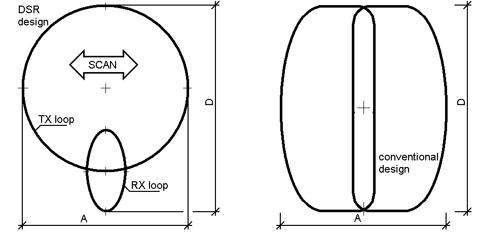

                Bad loop configuration
                It was more expensive. The price of DRS GroundExper was even €5500 in August 2013 according a Bulgarian forum:
                According a German forum, the price was reduced to €4000 after 4 months:
                Aziz, I’m sure that you can design and build an ANDROID metal detector for less than €400. Your design will be more sensitive because DRS uses bad dimensioned loop configuration in search head. Here is attached a sketch for explanation. Note that both configurations have equal overall dimensions A and B. The surface of RX coil in DRS design is very small relative to those of a conventional DD loop cofiguration. Even the TX loop in DRS head is smaller. The conventional DD configuration makes more wide scan.

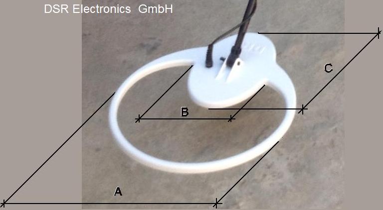

                • Mikebg would you have the dimensions of that drs coil please ?
                  having a little trouble with translations on web
                  thanks
                    thanks
                    No, but I asked the same question on 23 January in metaldetectingforum, which is conducted in English language. So far, there is no response.
                    Hello, what do you think about a new metal detector company Drs Electronics and its metal detectors? New detectors with super technologies or only a good marketing of eastern founders of the German company? Just look at http://www.drselectronics.de.
                    The Ground Exper is standard completed with three search heads. According to the company website, search heads have dimension 8.86" (the small one), 17.71" (the medium one) and 39.37" (the large one). I guess the first two numbers correspond to the dimension A (overall diameter of TX loop in my sketch of induction balanced heads) and the third dimension (39.37" = 100 cm) refers to the side of a square frame which operates as Monocoil.
