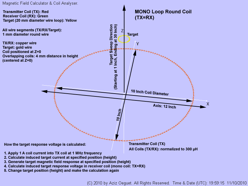

        • Preparation for Coil Analysis
          Hi all,
          I will analyse mono loop round coil, induction balanced coils (DD and concentric co-planar), figure-8 coil (anti-interference coil), and maybe the two-box coil too. The latter two types are quite difficult to manage as the max. sensitive position is not on the center of the coil configuration.
          Let's take a total coil size of 10 inch diameter (round, 254 mm diameter). Single coils will have an inductivity of 300 µH (TX=RX=300 µH). Seperate TX/RX coils should have each 300 µH coil (TX=300 µH, RX=300 µH). Compound TX coil should have total 300 µH. DD coil size will be the same total size of the mono loop coil.
          Transmitter coils (TX) will be displayed red. Receiver coils (RX) green. Both TX, RX wire will be 1 mm diameter round copper wire (as simplified coil model). Target (20 mm diameter, 1 mm diameter single loop wire coil) yellow (gold conductor).
          The target will be placed on it's sensitive hot spot axis of the coil configuration and will be swept from 1 inch to 30 inch distance (height) (1 inch step size). The target response voltage seen by the receive coil will be calculated and all the coils will be compared together later. If there is no real receive coil, than the transmitter coil is acting as a receive coil.
          The transmitter coil will be excited by a 1 A coil current at 1 MHz. I am using the 1 MHz high frequency excitation just to increase the very low voltage levels to have some more accuracy. Otherwise, I would have lot's of zeros in my numbers. Skin effect is not taken into account (not to worry about the 1 MHz). All coil models are just simplified wire models (less work and fast). For our purpose, the simplified models are accurate enough for a proper comparison of the coils (Biot-Savart model).
          Below is just a scheme of a mono loop round coil with some infos. I will put the scheme of the coil and the calculated target response voltage together.
          Let's start.

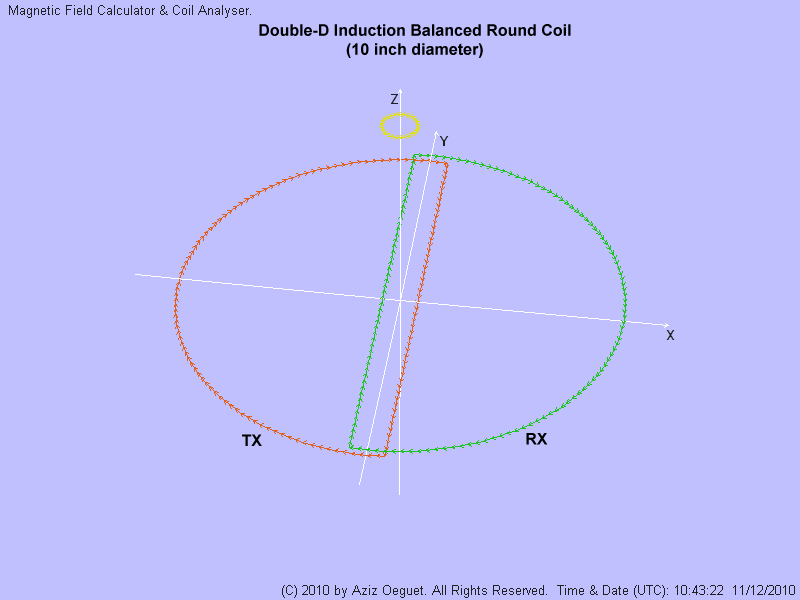

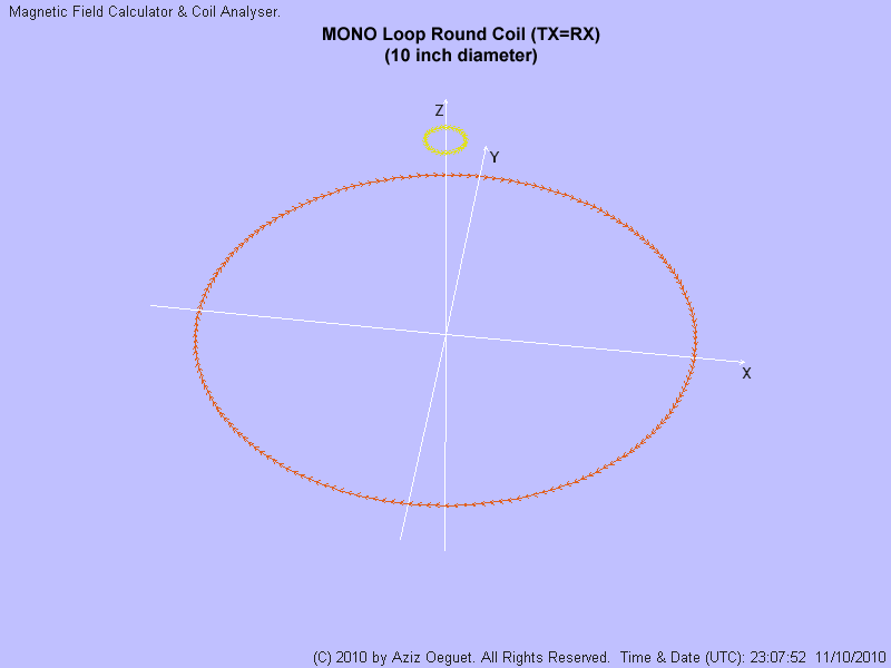

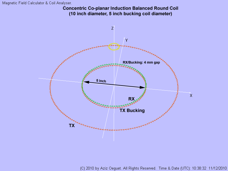

                    • Coil Schemes
                      Below are the coil schemes of three different coil types:
                      - Round Mono Coil
                      - Round Double-D (DD) Induction Balanced Coil
                      - Round Concentric Co-planar Induction Balanced Coil (inner diameter 5 inch)

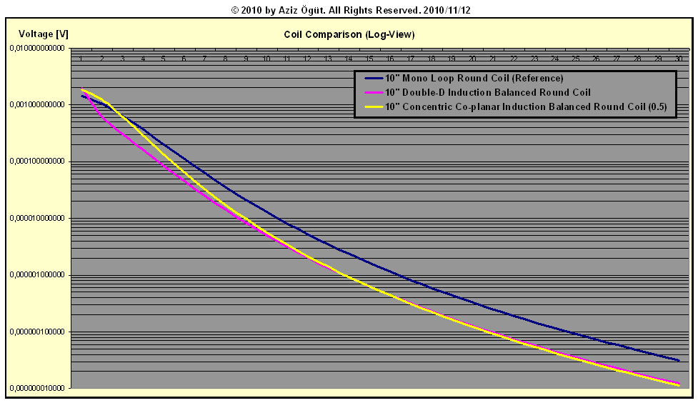

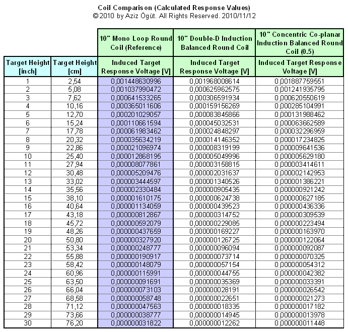

                      • Coil Comparison Results
                        Below are the results of the coil comparison:
                        - Calculated values
                        - Comparison chart (log-view)
                        Discussion will follow..
                        • Hi Aziz,
                          mono sems not so bad.
                          What exactly mean Target Heigt? Distance between target and coil (coil above target)?
                          Can you calculate different type of wire (Cu, Al) and shielding too?
                          Hov do you supply this coils? By sinus? By rectangular? By pulse?
                            Hi Aziz,
                            Yep, that's right. Similar to air-test configuration. Just elevate the target above the coil and measure (calculate) the target response only seen by the receive coil. Self induction/IB mismatch of the TX coil into the RX coil is not taken into account (not relevant for target response only).
                              Hi Aziz,
                              I see, you have put more questions.
                              Yes, I can use different type of conductors. But they haven't relevance for the coil current as I am using a current source drive (1 A at 1 Mhz). Shielding effects were not taken into account (this is a highly non-trivial job man, I am using only simplified models).
                              My simulation software uses sine-wave currents (easy calculation). The first derivation of it is used for the induction calculations and the maximum value is taken. So effectively max. dI/dt is taken for target response calculations. For our comparison, this is irrelevant. The performance of the coils apply to other current wave forms too.
                              Note, that the comparison is made under same conditions: same inductivity (300 µH), same coil current, same frequency, same target, same coil case diameter (10 inch), etc.
