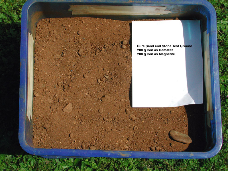

                      • Hello friends,
                        my very special hot mineral ground is getting step by step finished. The mixture of sand, stones and soil is quite colored (red/brown). My fingers too. The purpose for this highly mineralized test ground is to study the reactive signal responses. Particularly the remanent magnetic materials such as magnetite. I will have roughly 0.4 kg iron in my test ground (0.2 kg for magnetite, 0.2 kg for hematite). I hope, this will be enough.
                        It could be necessary, to experiment with degaussing PI's by applying a bipolar magnetic field pulse (alternating magnetic field).
                        Now next step to study:
                        Fully balanced differential front-end using instrumentation amplifier. Let's see, whether there is some benefit. I will test this on my basic PI board.
                        Aziz
                        • Hi all,
                          the highly mineralized test ground takes some time to dry out completely. We had a lot of rainy days last week. The reason for the complete dry out is the following: the ferric hydroxide in the test ground does not convert into iron oxide (hematite) if it is wet. Anyway, it got quite red/brown till now.
                          BTW, I have found a way of increasing the signal-to-noise ratio (SNR) of one decade. There is even potential for 2-3 decades. But it requires a completely new ground balancing system.
                          Aziz
                          • Mineralized Test Ground
                            Hi all,
                            finally, my mineralized test ground is finished (see below). Even though the original sand was quite bright, it changed its color into brown. It is looking like humus but no organic material is in it yet. Pure sand and gravel mixture.
                            Aziz
                            • Test Bed
                              Hi Aziz,
                              All you need now is a gold nuggy or Dougy's ali. block or then again some ali. foil squares, it's a pitty that there isn't a standard set worldwide as to what to use for testing of depths and nulling of the ground effects.
                              Regards Ron
