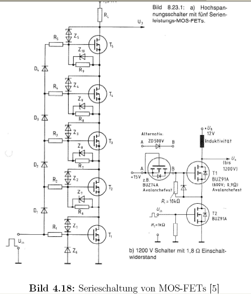

      Parts I have seen at Reichelt are limited to 1200V (SGP07N120).What is the difference converter / inverter ???
      I don't use IGBT's. The SGP07N120 is just a joke (7A at 1200V)!
      I need very very low on-resistance mosfets (<20 mOhm). A lot of blasting energy should be recovered back (power efficiency).
      It seems, I can cascode a lot of IRFP4668 to achieve higher breakdown voltage (as much current as the mosfet driver delivers of course). The IRFP4668 has Rdson of 9.7 mOhm @200V.
      Aziz
      • Originally posted by AdrianM View Post
        Are you really serious? A public posting becomes prior art, and if no inventive step is added to the plublic disclosure then it's worthless to the trolls. This is an example of such a precedence.
        Yes, I am very serious about this matter.
        BTW, I have found another solution on internet for discussion (see below).
        File: Leistungsschalter.pdf (page 42 of 69).
        Don't know the source anymore (stored on my hard disk).
        Title: Leistungstransistoren, Ansteuerung und Schutz
        Fach: Elektronik 1, SS07
        Just google it. Maybe someone can find it.
        Aziz
