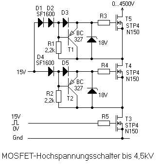

          BTW, I have found another solution on internet for discussion (see below).
          File: Leistungsschalter.pdf (page 42 of 69).
          Don't know the source anymore (stored on my hard disk).
          Title: Leistungstransistoren, Ansteuerung und Schutz
          Fach: Elektronik 1, SS07
          Just google it. Maybe someone can find it.
          Aziz
          ... here is another version.
              [ATTACH]16347[/ATTACH]
              Thanks moodz,
              this is a very fine circuit indeed. I have to spice it some day.
              Cheers,
              Aziz

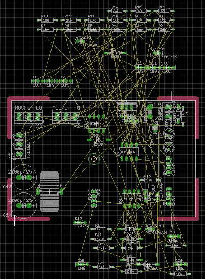

                    • Hi all,
                      after looking for a suitable case in the internet, I found a convenient case that attracted me. Then I remembered it and did take a look at my parts stock. I have two of it at home.
                      Well ok, all parts should fit into the box easily now (EURO-Box 135 x 95 x 45 mm). The PCB size will be half of euro format (100 x 80 mm), which can be produced cheap when taking the attractive two layer euro format PCB offers.
                      Aziz

                        This looks pretty exciting. Tell us as much as you can about the design. Also interested in the layout tools you are using.
                        -SB
                          -SB
                          Hi SB,
                          I'm using Eagle 5.0.0 currently. It's a so called "trial version" I found somewhere and I am testing it to decide, whether I should buy it or not. (Well, it hasn't any limitations obviously - could be infected with trojans or so).
                          The design of the control box is very much trivial. It's not worth to talk about it and let's guess & puzzle big players and patent trolls ().
                          It probably makes the bigger and professional former version obsolete. Always loved the K.I.S.S. principle. Well, I am going to test it soon.

                          • Hi all,
                            well, I'm using Eagle only to see, whether all parts fit into a board at the moment. And I can optimize the functional parts location.
                            Well, I'll do a bread board until I know, the circuit is simple and optimal. Then the final PCB will be routed & manufactured of course.
                            I also might change the design slightly due to performance improvements. Please be patient until I have finished this small project. I will publish this design to make a reference platform for the laptop/netbook experimenters.

                            • Hi all,
                              it seems, that all the parts are fitting much better into the half euro format PCB. And there is some space for an active analog power supply filter.
                              I have taken the simplest unipolar inverting pre-amp architecture (AC coupled) and this beast needs very clean power supply and hence the need for the active power supply filter. Well, I have to look, whether this is necessary at all.
                              Aziz
                              • Yep!
                                Active power supply filter makes really sense and it improves the SNR (according to spice simulation: 20 - 30 dB). It only needs 6 additional parts and they can be left unpopulated on the board, if not really necessary. I'll support this feature in case of having more power supply problems (high ripple voltage, noise, etc.).
