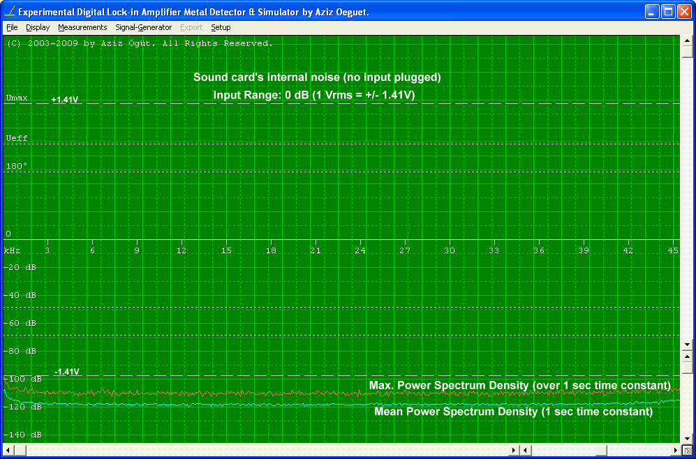

  • Hi all,
    I want to show you some FFT displays (visible up to 45 kHz using the better sound card). So you can make your own thoughts.
