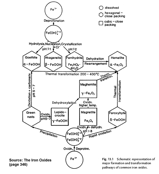

                          • Below is the iron II and iron III oxidation process path.

                            I have followed the long lasting bottom Fe2+ process path:
                            Green rust -> maghemite.
                            Note, that the cubic lattice is the high magnetic susceptible state.
                            Aziz
                            • So in reality you may produce a mixture of magnetically susceptible materials that are quite close to the natural hot rocks by doing a bit of barbecue? That can't be that difficult. I'll try to find (again) some self igniting charcoal, crush it and mix with yellow pigment iron oxide. Its not a BBQ season so it'll take me some time.
                              Anyway, I think I found a perfect maghemite hot rock stand in: a "normal" cassette tape. It is supposed to come with fine grain magnetic domains and they are not messy. I tried one with my IGSL and it was educational
                                Yep, the old cassette tape (red/brown) consists of very fine grain maghemite. But it could be difficult to get these today.
                                BTW, some maghemite is also produced in red/brown bricks. It's the maghemite and magnetite (ferrimagnetic), that makes detecting difficult. Not the hematite (anti-ferrimagnetic).
                                I have choosen the Fe2+ wet oxidation path to produce the fine grain sized maghemite (nm to µm sized grains). Using tensides (washing powder ) help reducing the grain size.
                                The charcoal method is dusty, messy and hot.
                                Aziz
