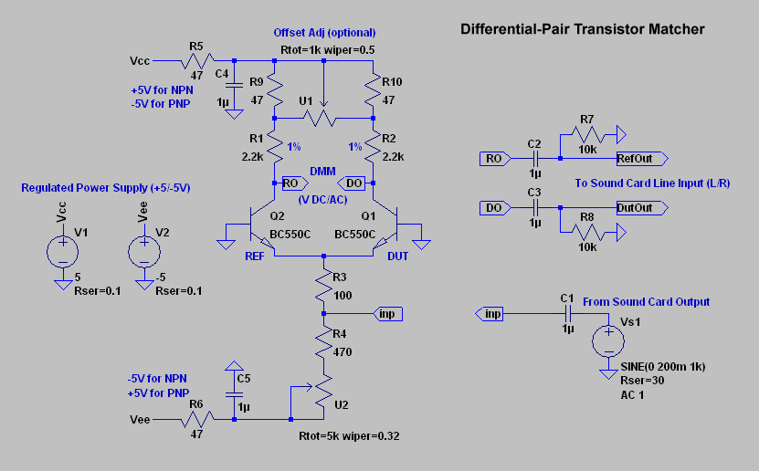

                    • Differential-Pair Transistor Matcher
                      Hi all,
                      here is the differential-pair transistor matcher. I have found this proposal somewhere in the internet forums.
                      First try to find two same 2.2k collector resistors (measure this with your DMM). Their matching accuracy should be better than 1%. Otherwise the offset voltage might be too much and the operating point moves into the saturation region of the transistors. If you have very accurate collector resistors, R9,R10 and U1 can be dropped.
                      Select the collector current (no signal fed into the inp). The pot U2 is for adjusting this. You can measure the collector current if you measure the voltage drop across R1 or R2.
                      Collector current = UdropR1/R1 = UdropR1/2200
                      For most applications, a collector current in the range of 1 mA is ok. So a voltage of 2.2V across the resistor R1 should be there.
                      Feed an AC signal into the inp input (1 kHz sine wave, Sound card/function generator). If both transistors Q1 and Q2 are well matched, the AC and DC voltage across the transistor collector will be low. The lower, the better matched. The DC voltage is the amplified offset voltage mismatch (Vbe mismatch). The offset voltage gain is around x80 I think (spice simulation).
                      Matching strategies:
                      1. You can compare REF against DUT (minimising the measured DC/AC voltages).
                      2. Or you can change the DUT's and note the measured DC/AC voltages. The two almost identical measured DUT's do match together.
                      Both transistors need a thermo coupling. If the temperature is differing, DC and AC voltages will heavily change. I recommend to place the whole circuit in a box during measurement. After both transistors get same temperature, the measurement can be done.
                      You can use any DMM for DC/AC voltage measurements. Or you can use the sound card.
                      Aziz
