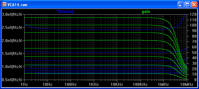

                    • VCA AC Analysis
                      Hi all,
                      this is the frequency response of the amplifier (below). I even had to compensate it to reduce the bandwidth. Collector current of differential-pair transistor is max. 2 mA (high gain). The input voltage noise spectrum density even gets better. Not bad yet.
                      Aziz
