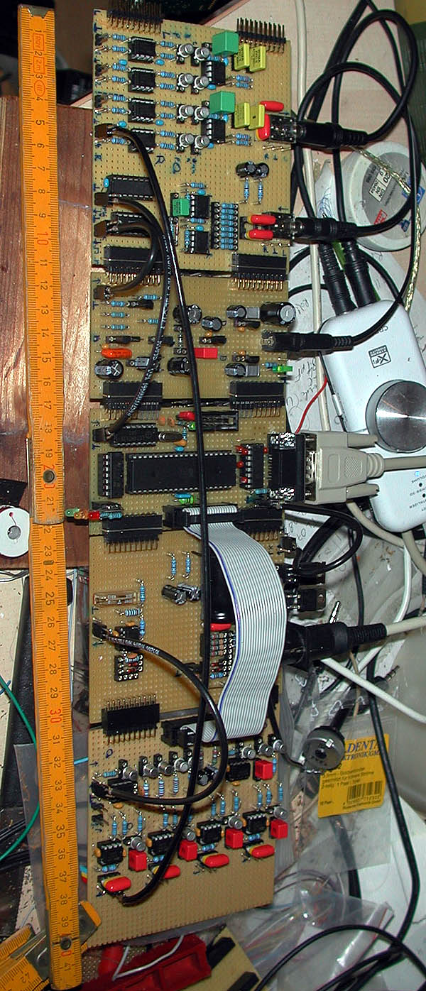

                • Hello friends,
                  I made the general proof of concept: It is working!
                  No, this isn't a 1. april joke!
                  I have tested on the last PGA, integrator and S&H board (the new improvements are not implemented yet). Following single channel data acquisition test is made:

                    • Hi all,
                      after getting a good and positive result, it makes really sense to follow this project further. All the 3-4 month of work was worth to make the proof of concept and to get the answer to my initial question.
                      The presented modules have to be optimized further for right signal levels to get maximum dynamic range (increasing SNR). I will also try other circuit solutions to get better results.

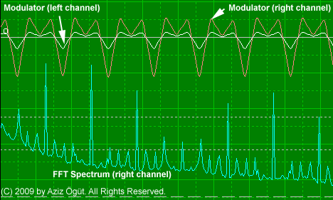

                        • Hi all,
                          you might want to see the modulator output. The picture below shows the uncontrolled S&H output stages (drifted end positions, TX pulses not running) and the modulated output of the S&H channels.
                          The channel signals can be directly decoded in the laptop software. The phase of the modulation gives the polarity of the channel signal.
                          Aziz
