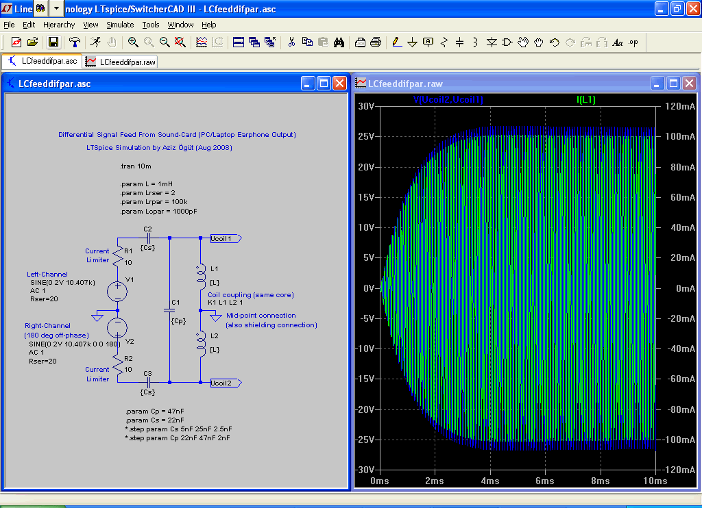

                            Why need separate sound card because of two frequencies? Most sound cards have at least stereo don't they? One for TX signal, one for headset. TX signal can be sum of two frequencies. Make coil with two resonant frequencies. No?
                            • Here is the schematics for doubling the transmit power through the coil. The coil (L1, L2) has a centerpoint-connection (mid-point) which is connected to ground. The shielding of the coil should be connected to ground or mid-point.
                              R1=R2, C2=C3, 1% (symmetrical feed)
                              The right channel must be inverted or 180-degree out of phase to left signal channel. Doubling the power does not mean doubling the detection depth! But some detection depth increase without any additional electronics is possible by using both left and right output channels (stereo-mode).
                              In this case, an additional sound-card is necessary for detection beeping!
                              See attachement and Spice model for further information. This is a general schematics and can be adapted to different inductivity and frequency of course.
                              Enjoy,
                              Aziz
                              PS: Remove the ".txt" file name extension for LTspice model then load into LTspice.
