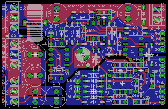

    • Current PCB Layout
      Hi all,
      this is the latest PCB layout of the detector controller (80 mm x 50 mm). Notice, I have put all big caps back again (because, there was some space there). C1 and C14 can be soldered optionally (if you need more power buffer).
      This PCB layout version is a hot candidate for manufacturing.
      Cheers,
      Aziz

              Thanks for explanation, that was very useful.
              I see a MOSFET driver on the board -- is there a MOSFET somewhere driven by that, or are you using it to drive the coil directly?
              Did I read correctly that this board supports both VLF (continuous wave) and PI designs, or is it primarily for one type?
              -SB
                -SB
                The board is supporting one and two identical n-ch mosfets. I have soldered a connector (screwable pins) to the bread-board in the earlier posting, so there is only one mosfet connected. One can quickly change to other mosfets (that's a typical prototype work around for mode changes). I have choosen the big mosfet case (TO-247) as I use them quite often. If you have decided the operating mode, you can also solder the mosfet into the PCB of course. TO-220 mosfet pins must be slightly bent.
                The single low-side n-ch mosfet mode:
                The coil is driven between VCOIL and TXOUT. This is the high voltage PI/TEM mode. TXOUT is the high voltage connection (drain of the mosfet). The connection R0 is open to keep the high voltage out of the mosfet driver. Although it is supporting voltages upto 600V, the capacitive load is blocked with open R0. We don't need the high-side mosfet driver part of the IR2184 in this case. The bootstrapping of the high-side mosfet driver is disabled. This mode supports VLF/PI/TEM + Hybrid-VLF/PI mode.
                BTW, it's cheaper. You only need one mosfet!
                The dual (low/high-side) n-ch mosfet mode:
                This is the H-bridge (Half-bridge) mode and you can use low voltage mosfets (30 V) as the TXOUT connection doesn't see a high voltage. The coil is driven between TXOUT and GND. Note, R0 must be shorted (zero Ohm resistor). We need the high-side driver of the mosfet driver in this case. This is destined for H-Bridge VLF mode operation.
                I'll give you more infos later how to use all the different operating modes. Nearly a dozen of modes can be realised!!
                Yes, you did read it correctly. It is supporting VLF (continious wave) and PI design (or both at the same time: Hybrid-VLF/PI).
                Cheers,
                Aziz

                        Thanks, that really helps clarify.
                        It is really nice. I just have reservations about sound card as sampling tool, high-end and low-end roll-off. Probably not big deal for VLF (continuous wave) designs, but still...
                        In my dreams, I'd like a board with the 24 bit A/D onboard (broadband as possible) and USB interface. I realize that is much more complicated and expensive and would require a software driver as well. Just wishing... your board is a very practical way to get started and to develop cool software algorithms.
                        Any sound cards that are hackable to go down to 0 Hz?
                        -SB
                        • Working on Open Issues
                          Hi all,
                          I'm currently working on the gain of the pre-amps. The Gain of 100 in the current schematics is way too much of course. We don't need it for the 24-bit sound card.
                          A reasonable value should be between 10x .. 50x.
                          The coil is picking way more noise than the pre-amp is generating. So a high gain isn't really necessary. We need to rise the signal level (with RX coil) just above the noise floor of the sound card. That's enough.
                          I will make some noise measurements with different input impedances and gains and will let you know, how to set the optimal gain.
                          Remember: Gain = - RG / Rin
                          The AuxInput impedance depends on the RG too. A gain for AuxInput should be 1x .. 3x (enough).
                          The NE5532 isn't that bad. It's very cheap too.
                          We need some minimum input impedance (Rin >= 47 Ohm) to protect the pre-amps. Even the RX coil isn't seing the TX coil voltage (due to induction balance), it could pickup pulses from other detectors or EMI. The NE5532 has built-in protection diodes on its inputs (*LOL*). But double protection is better. (We could save 4 x 1N4148 but we could put a different dual op-amp, then we might need them again).
                          Well, you really get with NE5532 a lot for your money.
                          Aziz

                            Hi SB,
                            I am wishing such an USB 24 bit A/D device too. Hey, we don't need them really. You could unscrew the USB sound card and could mount the PCB into the controller box too.
                            We don't really need the DC response capability (down to 0 Hz).
                            Our pulse measurements are modulated with the pulse frequency and we get therefore an AC response. But we need the upper frequency range (>20 kHz). Some dumb manufacturers limit the upper frequency and advertise it as a 96 kHz sampling rate sound card! Fine, but for what? You have to look at the input frequency response range.
                            Fortunately, there are sound cards available, which can be used upto 48 kHz signal frequency (96 kHz sampling rate, input frequency response corner frequency at approx. 46 kHz).
                            There will be sound cards, which will support even 96 kHz signal frequency in the future (192 kHz sampling rate). These sound codec chips are flooding the market at the moment.
                            We can use the 48 kHz sampling rate too. That's not the problem. We will miss the small targets only (or we will have less sensitivity to them).
                            And we should concentrate our TX frequency response energy to the supported input frequency response range. Otherwise, we would waste TX power. Better focus and concentrate it to the supported frequency range.
                            For frequency-domain metal detection, a frequency range of 100 Hz to 100 kHz is really enough. And I'm waiting to get the upper range soon with the 192 kHz sampling rate (SR) sound cards. But I can live with 96 kHz SR too. Or with 48 kHz SR.
                            Aziz
