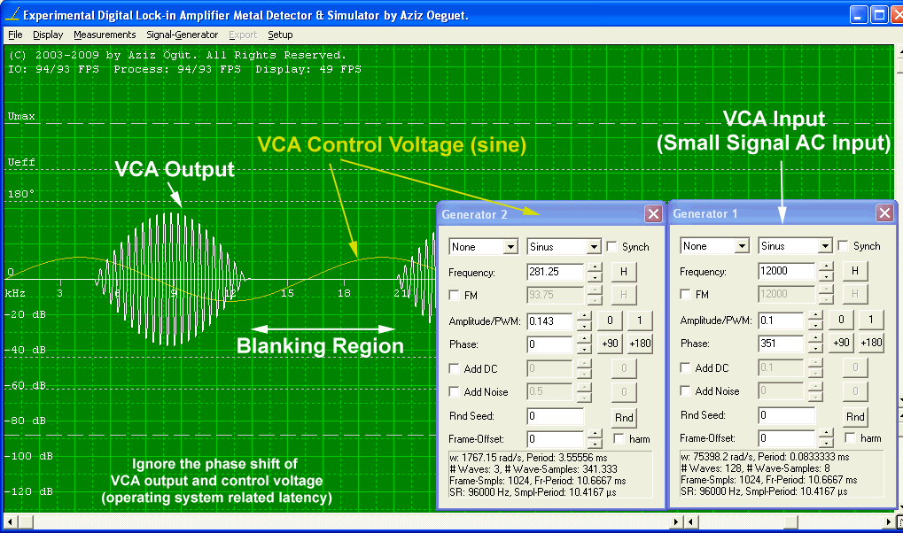

      • VCA is working.
        Hi all,
        finally, I have finished the VCA. Have a look at the output (see below). It's working very nice and quiet. I can go a step forward towards the pseudo mono coils (low coupled TX/RX coils = mini ground loop coils) now.
        Cheers,
        Aziz

          • Try searching on SSM2164 for integrated VCA chip used all over the place for electronic music apps. Analog Devices I think just did a last buy offer but THAT makes a part that can be used functionally in its place (2162).
            • Originally posted by bklein View Post
              Thanks bklein,
              indeed interesting noisy chips (a lot noisier than mine). And they have the same temperature dependency as the simple design above. Unfortunately, all VCA's critical issue is the temp. dependency.
              Well, I'm not satisfied with the temp. dependency, which is causing drift of course. I haven't tested the VCA circuit in the MD yet and will see, whether it can still be used for it.
              The fixed gain pre-amps (or let's say better, the stable control feed-back loop amplifiers) doing much much better of course. I'll probably use two fixed gain pre-amps, which should be switchable (controlable on/off).

                  I've found, that VCA is really very critical in low signal detection & processing. Unfortunately, my sound card test measurements reveal it's almost useless application. The temperature compensation is mandatory and is required. I do not need to test it in a MD application therefore. Although, it is a very quiet & nice circuit.
                  Regarding the log-amp: Same problem with temp. gradient.
                  (Not required to test it too as the pn-junction (diode, transistor) voltage vs. current is temp. dependent too.)
                  Best solution is:
                  - fixed gain (=stable feedback-loop),
                  - gate-able signal source,
                  - two different gain dual channel pre-amps.
                  Cheers,
                  Aziz

                        Hi bklein,
                        thanks, I have seen this circuit. However, what seems to be good in audio applications, it's a totally different ball of game in instrumentation applications.
                        If I would invest more effort, I would invest in a temperature controller and put the whole VCA into a small box (module).
                        But that's not the point. All the effort isn't really worth just to make a few experiments.
                        Regarding the SSM2164 (data sheet facts):
                        Noise: -94 dBu for 20 kHz bandwidth, which results in 15.5 µV (Rms) noise.
                        Gain Constant Temperature Coefficient: -3300 ppm/°C (-3,300/1,000,000 = -0.33 %/°C)
                        No, no way.
                        Input signal gating can be done much simpler and cheaper. A two stage amplifier with each fixed gain and outputs would be enough to make the experiments.
                        BTW, the temperature dependency in my circuit comes from the differential stage. So this kind of VCA isn't convenient. I'm not following it anymore.
