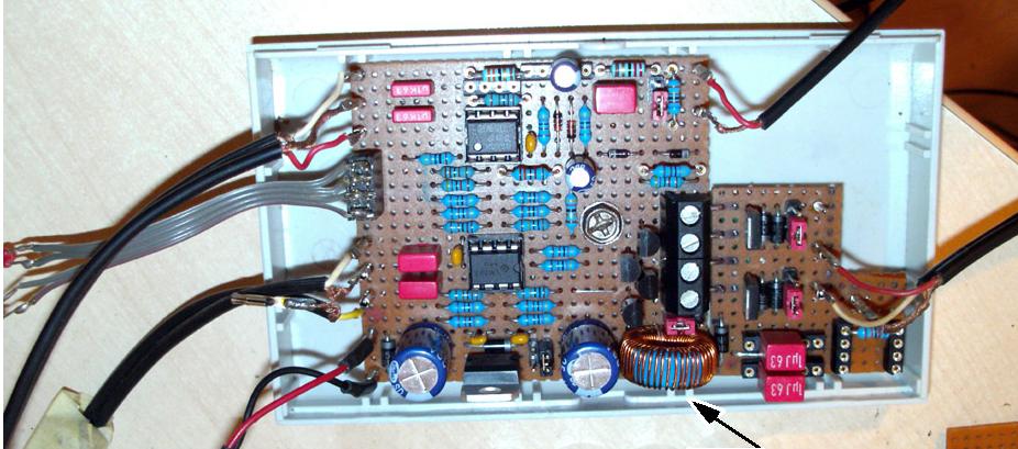

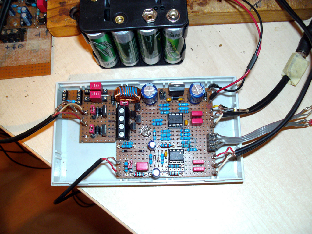

    Hi all,
    my prototype is working very nice.

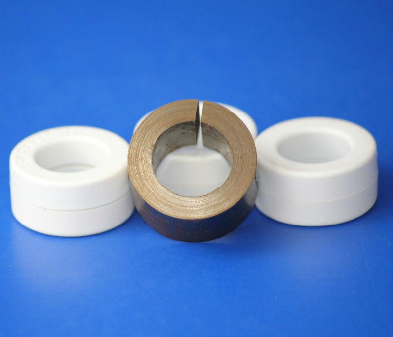

                              Please do not rename the Majik Choke into the Majik Smoke. In the attached here photo, an arrow shows the Majik Choke. From it is seen that the magnetic core has no air-gap. The discoverer of Majik Choke not knows that when in a choke flows large DC component, the core should have an air-gap, bu he will google for “air gap choke” and will read this:
                                Paul, you write crap because you have not sobered up from New Year's Eve.
                                Nothing is simulated! Do not you see that there is a real working model? It will become THERMONUCLEAR SMELTER in the 2014 with new TX.
                                http://powerelectronics.com/content/why-have-air-gap
