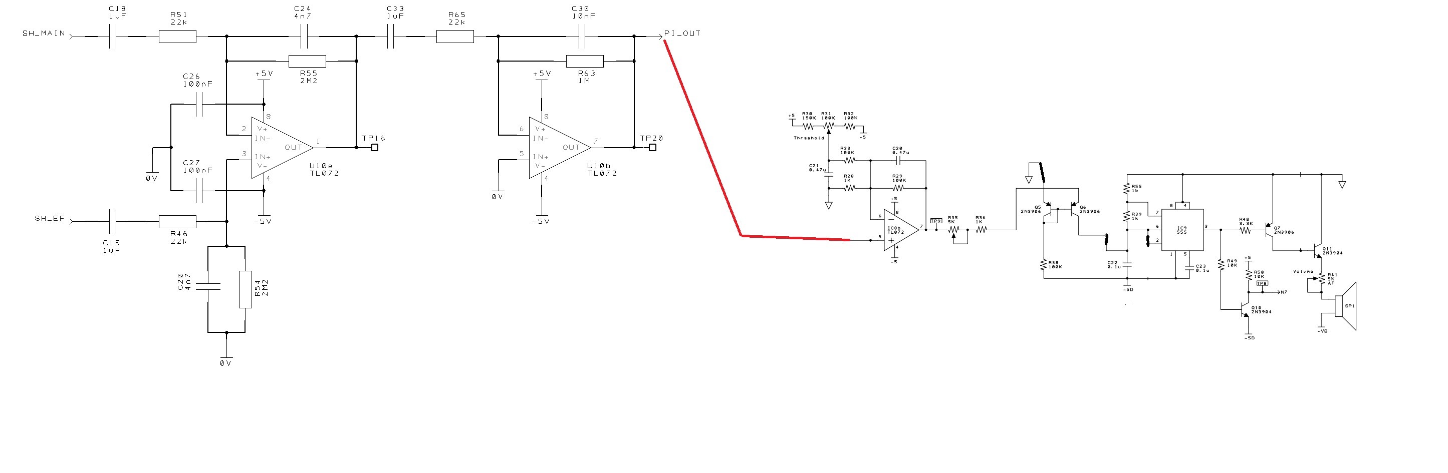

        I'm going to add HHD Audio part to my Voodoo.
        Is it possible to see the attached, do you think the schematic and its values are true?

            Originally posted by h9361 View Post
            Dear Qiaozhi
            I have never built Mick's audio circuit, so you will have to just experiment. That's what most of us have to do anyway.
              Dear Qiaozhi, the schematic belongs to HHD, not Mick's audio.
              Do you think i can connect the audio part of HHD ?

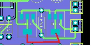

                If you cannot find the correct MOSFET then simply short out that section of the design. Of course it will mean that you will have to be careful not to connect the battery pack the wrong way round.
                Is it your mean?
                  Is it your mean?
                  Please forgive me, is it possible to guide me how to short it on pcb?
                    Yes, short the MOSFET drains together.
                      Thank you.
                      Is it correct?
                        Yes
