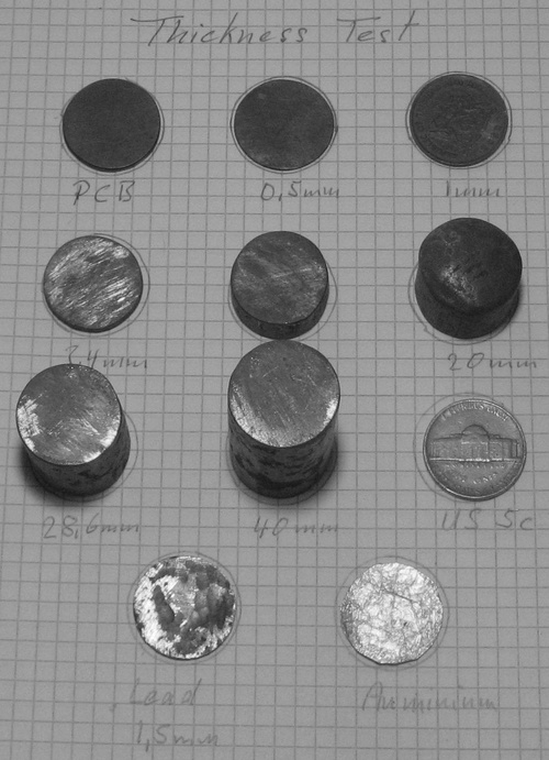

                  Some time ago, I posted the test results of about 6 different copper disk targets. (if only I could find the post) All targets had the same diameter, but different thickness.
                  The target thickness varied from a single sided copper PCB disk to about 1.5".
                  The target response, in mV, taken at the output of the front end, seemed to be proportional to the thickness.
                  If the only target response were from the skin effect, the thickness would have no bearing on the response amplitude.
                  I still have these targets in my sample target box, so I could repeat the test.
                  How should we set the test parameters to obtain more information?

                      I think we misunderstood.
                      The samples are of different thickness.
                      All samples have approximately the same diameter or surface area.
                      The thinnest copper sample is a PCB cutout.
                      The next one is 0.5mm thick.
                      etc.
                      The thickest is 40mm thick.
                      I will add a picture of the test targets.
                      I will re-do the test and add a disk of alu foil and a disk of lead, just for kicks.
                      The measurements are in mV.
                      It will be your job to calculate the difference in response amplitude due of the skin effect and the response due to thickness.
                      Everybody is invited to help making sense of it.
                      The results might be very interesting.

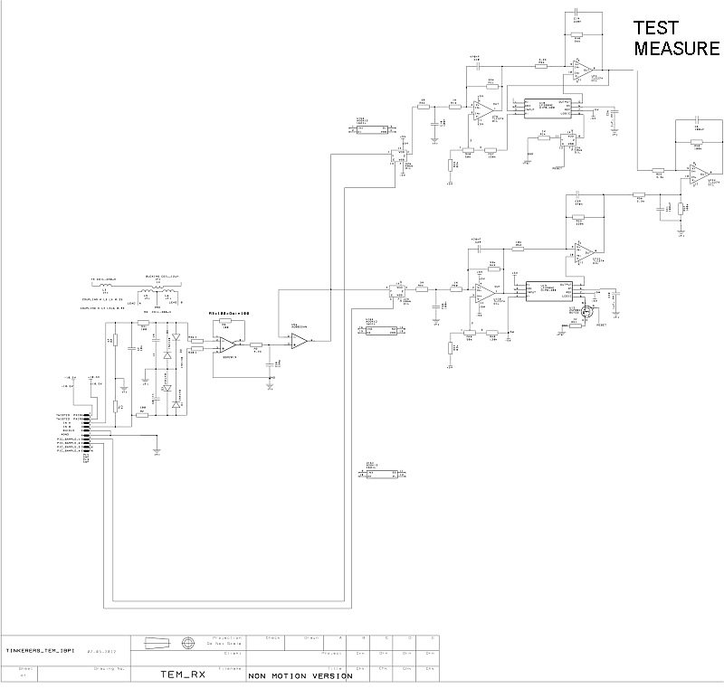

                      To make it still better, I am going to add the RX circuit so that you can see what the gain is and how much processing the signal underwent, since this may explain something.

                          OK, I am ready for testing.
                          For the coil I have a 45cm (18") diameter coil, not shielded.
                          The targets are placed on a plastic box, 25cm (10") above the coil. Static measurement.
                          For the RX, I use a non-motion setup, because it is easier to take the measurement on the scope. The Schematic is attached and the point of measurement is indicated.
                          The measurements are not high precision, about +/- 5% accuracy.
                          To make it a bit more interesting, let's see who can guess.
                          I have taken 2 measurements already.
                          One is 50mV
                          The other one is 200mV
                          To which targets do these measurements belong?
                          A picture of the targets is attached.

                            Uploading schematic
                            The picture and schematic did not upload, so here we try again.
                            Again it did not go, so I try one at the time.

                              Test samples
                              Here are the test samples.
