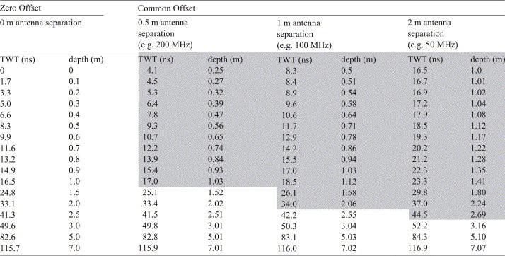

            This is for GPR (out of MD frequency range), but interesting results:
            More here:
            http://www.sciencedirect.com/science...12825204000054
