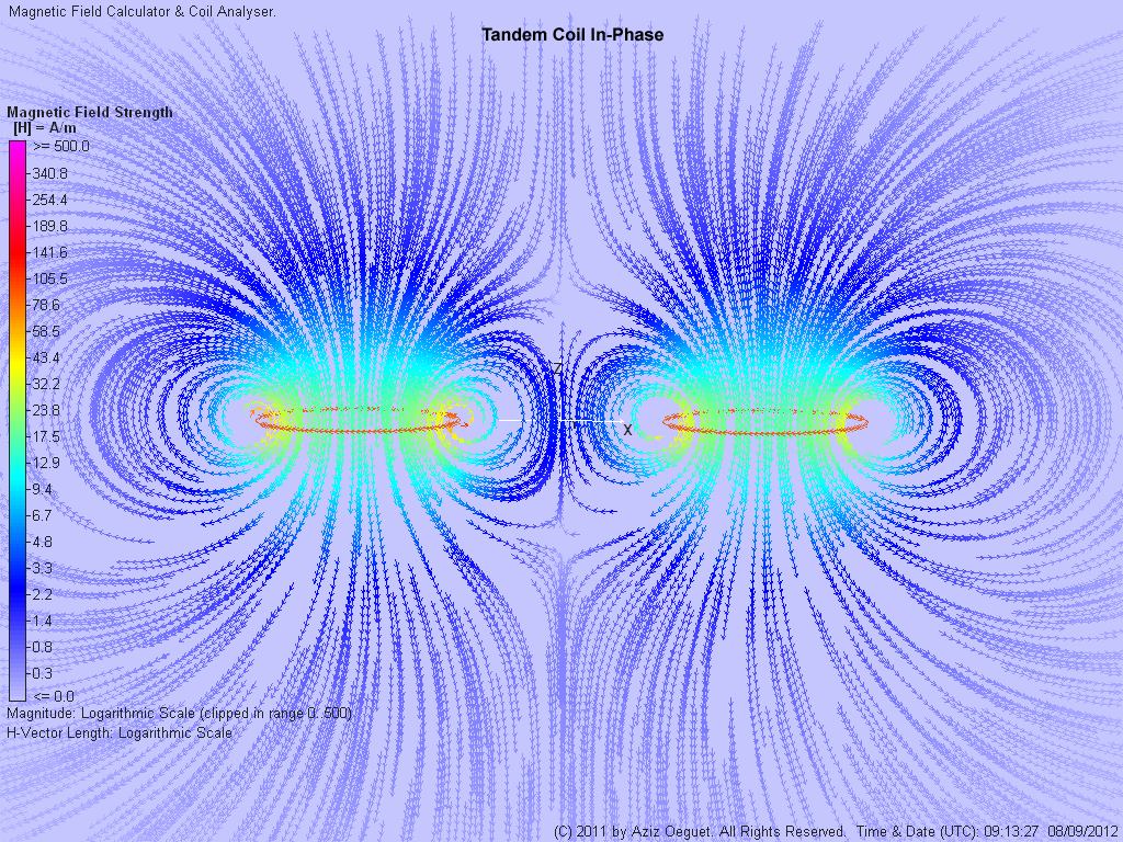

              Hi guys,
              sure, I can provide you nice magnetic fields.
              Please specify the exact parameters of the coil configurations.
              But it will take some time as I have not much time right now.
              Aziz
                There is not much to specify. Just model two Tx circular coils D=50cm with one diameter free space between them, wired parallel in phase and inside each of the Tx coil put one Rx coil at D=48cm, and wire the Rx coils in antiseries. Please do the magic you did for the DD configuration before :wink: :nudge:
                I think it is important to wire Tx coils in parallel so that voltage is the same on both of them regardless of the ground proximity, skew etc. Thus the Rx coils will see the same voltage as well and maintain the balance better. Right?

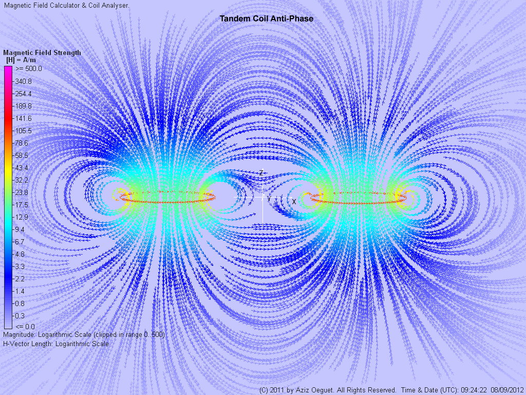

                        Tandem Coil Magnetic Fields
                        Hi all,
                        this is the tandem TX coil in in-phase and anti-phase configuration (50 cm coil diameter, 50 cm distance, 1 A coil current). I didn't put the RX coils so you don't get confused. Both configurations were normalized to approx. 300 µH total coil inductivity.

                        • #42
                          Thank you Aziz.
                          This is very interesting. It shows how the in-phase will give more depth and the anti-phase will better find the targets that are hard to find with the single coil, due to their shape and orientation.
                          With the anti-phase coils, an orthogonal RX coil above the center of the 2 TX coils might give interesting results.

                            • #44
                              ...I didn't put the RX coils so you don't get confused...
                              Please do With in-phase and counterphase multiplied, we'd get a real picture of what this setup does. E.g. points where these fields are orthogonal will give zero response in Rx.
                              This looks very promising.
                              @Sergey_P, please note that the single largest constraint to go any deeper is Rx sensitivity. With natural and artificial noise sources you are limited by EMI, various noises, and the ground signal much more than you can gain by aiding the field. In fact, you can get the most field by a simple circular coil, just like with the monocoil - exactly like in your example above.
                              To put things in perspective, with voltage gain of *10 (or 20dB) you obtain ~40% increase in depth. "Normal" VLF has sensitivity at ~0.5μV with a 15mH coil, and it is far above the thermal noise floor. Going lower than that make little sense because of the chatter thet is a result of excessive noise. So the major constraint is additional noise on top of the thermal noise. High energy natural sources of noise are usually of impulse type, and I expect to see that 20dB reduction with this coil configuration.
                              Ergo, to go any deeper with a coil of the same size you need every means available to reduce noise. I can imagine:
                              - EMI (and ground signal) fighting coil configurations
                              - better balance methods
                              - target response discontinuity somewhere on a coil system to aid motion detection and/or pinpointing - a sharp signal change will pass through motion detection even at a very reduced sweeping speed AND improve resolution for small targets
                              I think the bicycle coil has it all. Guess the coils distance can be optimised for depth.
