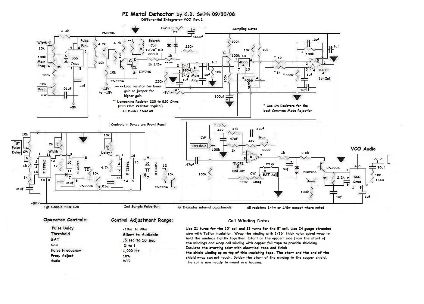

                  1. What PI design are you making?
                  It's an attempt at building the HH variation designed by Smitty II over on the Findmall forum. Here is his schematic.
Name:	CBS PI-1A Rev 2 with VCO Audio.jpg

                  4. What MOSFET part number are you using to drive the coil?
                  NE555

                    MOSFET is not NE555, but the IRF740...
                      Thank you. I wasn't sure and that's why I attached the schematic.
                      Bob
