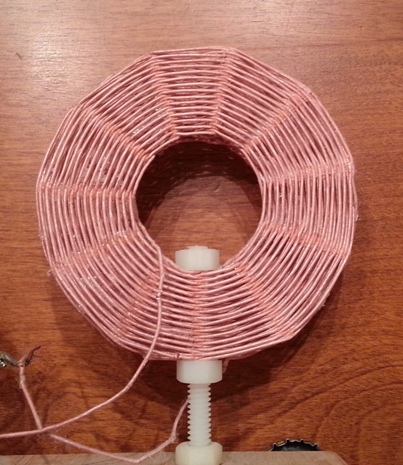

        Just for fun, I grabbed the highest "Q" coil I could find, around 270 uH 175/46 Litz, and connected it to one of my Baracuda circuits. I know.. the dampening resistor kills "Q" anyway but I wanted to see if I could minimize any eddy currents and eliminate all the parasitic capacitance that I could.. Not optimal at all for Litz but I thought that I would see some improvement over 22 gauge stranded silver with Teflon insulation.. No improvement at all!
        I could however shave a good 5 or 6 us off of my decay curve by rewinding my 22 gauge coil to a basket weave.
              Now that sounds really impressive. Will a basket weave coil fit one of your standard coil covers, or do you need to use a full clamshell cover?
              Bob
                But then again, like everything else, the low capacitance from the basket weave coil is a compromise and comes at the cost of reduced magnetic field due to the spacing of the windings?

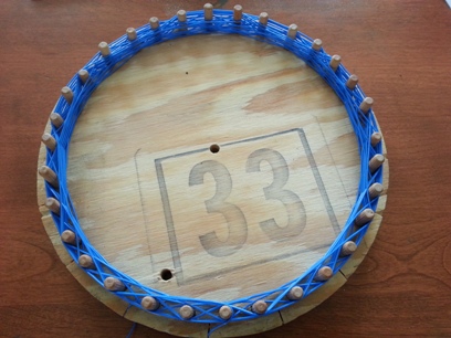

                  I have not seriously considered actually using just because I don't hunt for tiny gold. I use longer delays to eliminate salt water and help eliminate ground noise at the beach.
                  The diamond weave litz coils are held together with a slurry of melted packing peanuts and acetone. I'm not sure how I would keep a basket weave coil together.
