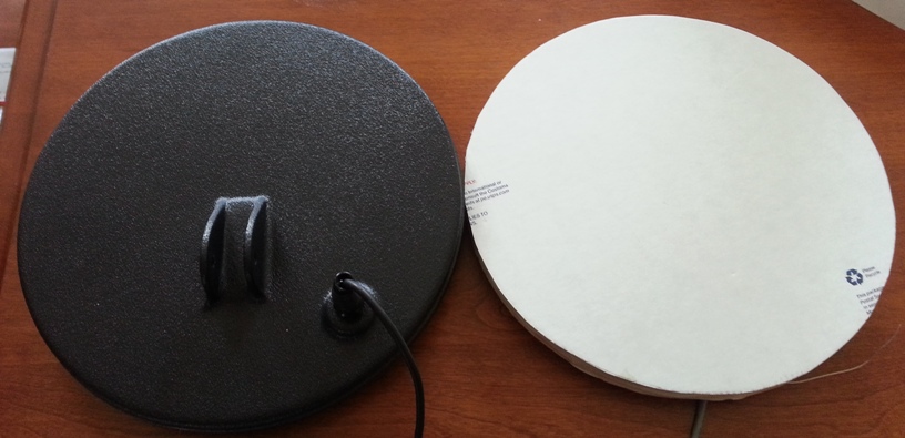

          I just fill the "ears" on the coil with epoxy and fiberglass.
            I have been using epoxy and thin strips of scrap cloth. Anything to give some binder to the epoxy. Works well.

              One problem I ran into was getting the epoxy to stick to ABS plastic.. only the encapsulating compound that I have been buying sticks well. I just bought some plumbers epoxy made for plastics at a hardware store to try. I would lke to know what solutions others have come up with.. pvc primers? Sanding??
                Could you use the potting compound as an adhesive - now that you know it sticks!
                Steve
                  Steve
                  Yes, that is what I have been doing but it is expensive and has a limited shelf life so I usually reserve the whole 350ml for a complete DD coil.
                  I was just looking for a more economical solution.
                  Don
                    I have been using Loctite two part epoxy. http://www.loctiteproducts.com/p/13/...a-Time-Pro.htm
                    It is expensive but on the plus side it works well and is available any time I need some at a store that is located less than five minutes from the house. It is also very slow curing.
                    I do swab the inside of the shell with PVC cleaner and also use some 150 grit sand paper for those areas where I can reach. I also cut pieces of 1/4 inch paneling to shape to fill void spaces between the coils to cut down on the amount of epoxy I use. I glue these in place along with one of the coils before proceeding with the second coil and more pieces of wood.
                    I have not made anywhere near as many coils as you have so my experience is somewhat limited. However I have not had any problem at all with the epoxy filler separating from the plastic shell, or separation between first and second layers of epoxy.
                    Jerry

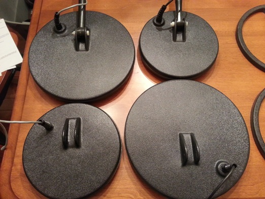

                      I finished some "garden variety" testing today on my latest 10" coil for the IDX project. Overall it was a successful project
                      Some notes on performance comparisons of 4 concentrics..
                      1. Performance of both 10" concentrics, one for the TGSL project and one for the IDX are for all practical purposes, identical.
                      The IDX coil wins in air tests by a long shot but the advantage is diminished in ground test. The TGSL 10" coil wins by 2 oz in the weight category.
                      2. Performance of both 7.5" concentrics, one for the TGSL project and one for the IDX. The IDX is the clear winner in the depth category.. almost matches the depth of the 10" coils.. but not quite. The 7.5" for the TGSL comes out ahead in the weight department (or lack thereof) and seems to have the cleanest discrimination.
                      Don.
