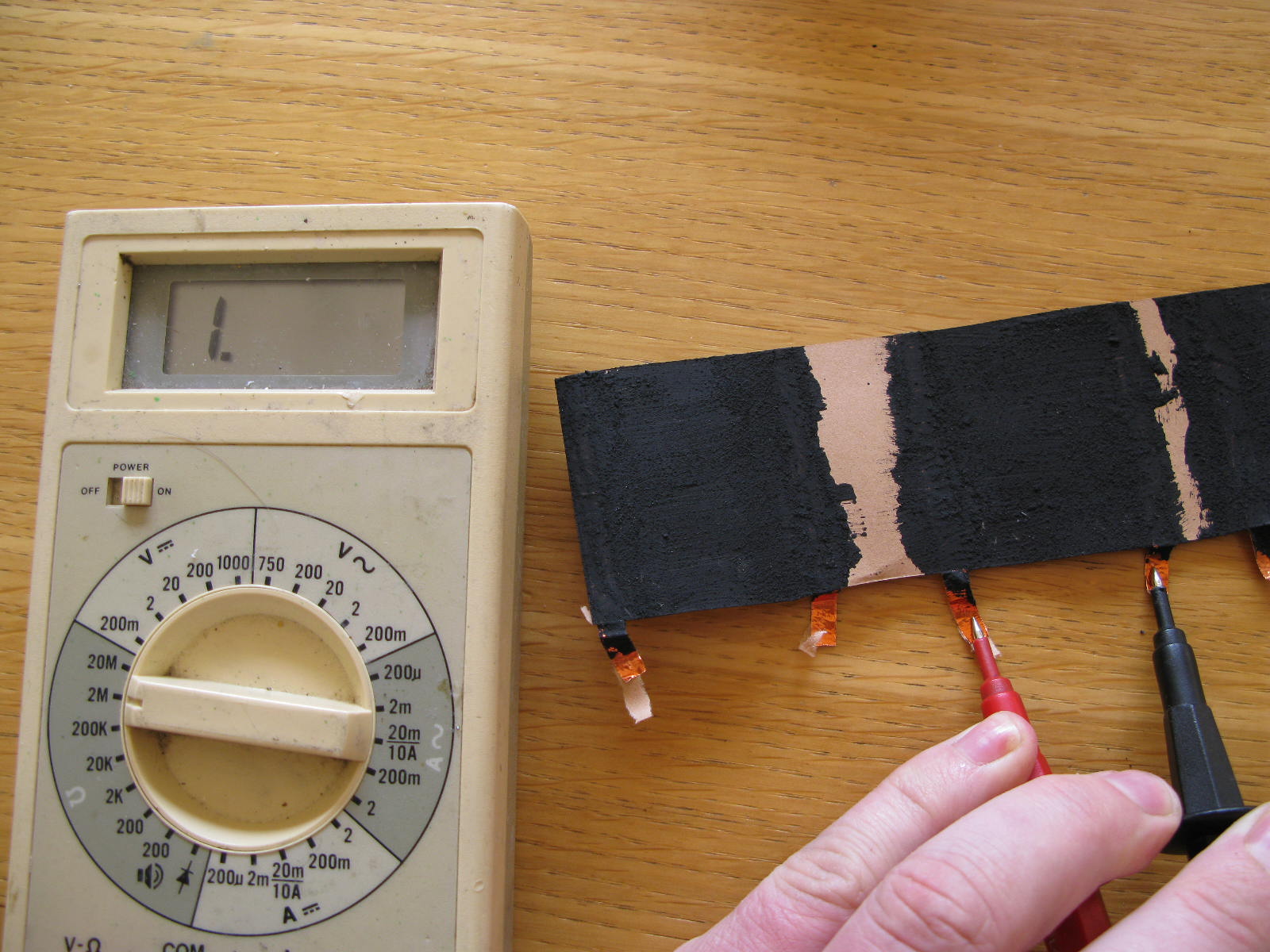

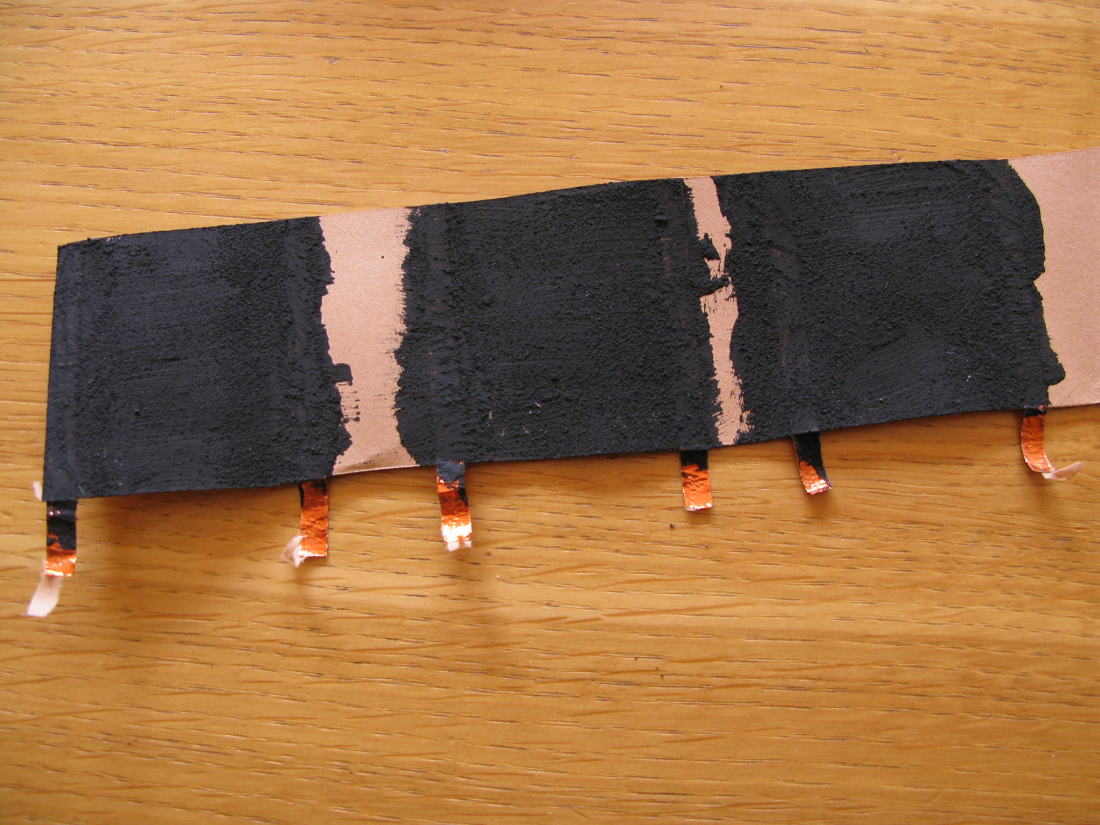

          Concentric for my IDX. Considering the sheild - I did some graphite test samples to get the ohms/square, my aim was around 10kohm/sq.
          I did three duplicate samples to get an average. Used copper tape for edge terminals. Made patches in square shapes for the ohms/sq resistivity measurement.
          Also did circular sample on plastic carrier.
          Water based black paint from economy store (wilkinson uk )
          One part synthetic graphite (Graphite trading Co UK ) - 3 parts paint - - - by mass.
          I did the three samples at the same time, from the same mix, the mix was agitated fully to get the graphite for each delivery.

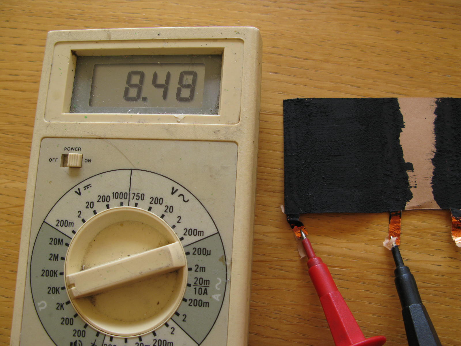

          Ovened at 80C for 1hr then measured resistance at the copper connections.
          Cell 1 10.5kohm
          Cell 2 open cct
          Cell 3 open cct
          Left overnight repeated measurement
          Cell 1 8.5kohm
          Cell 2 open cct
          Cell 3 open cct

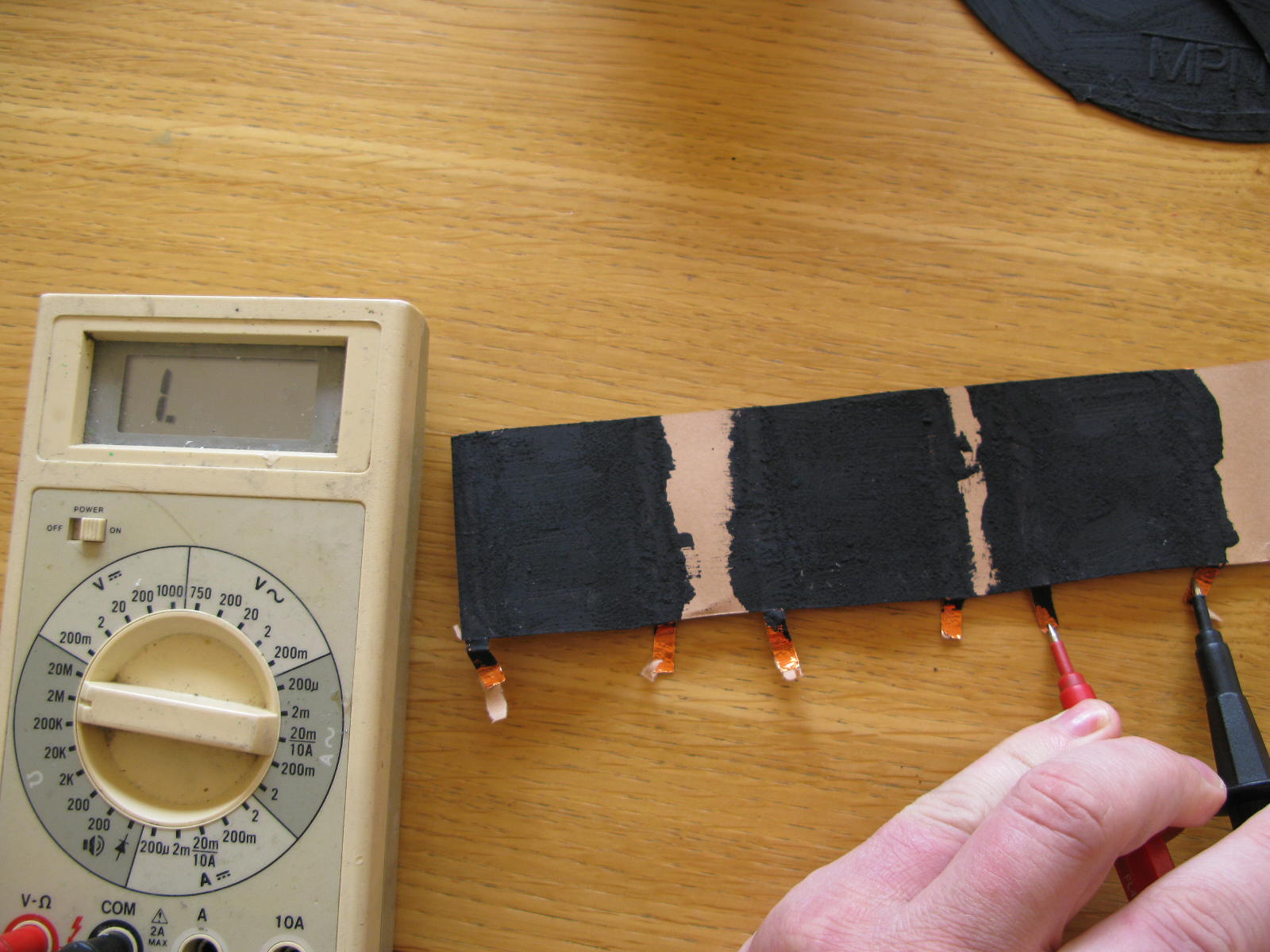

          I was a little dissapointed with the random nature of the reliability shown with my test.
          Looking further, there are areas on the defective cells where I get a low reading, but alas it is not continuous across the test piece.
          The circular disc on plastic was open circuit.
          Need a way to deliver the grapghite payload so all of the grains touch.
          The other thing is Im nervous the paint adhesion to the shell will be weak and my coils complete with potting will flop out one day !!

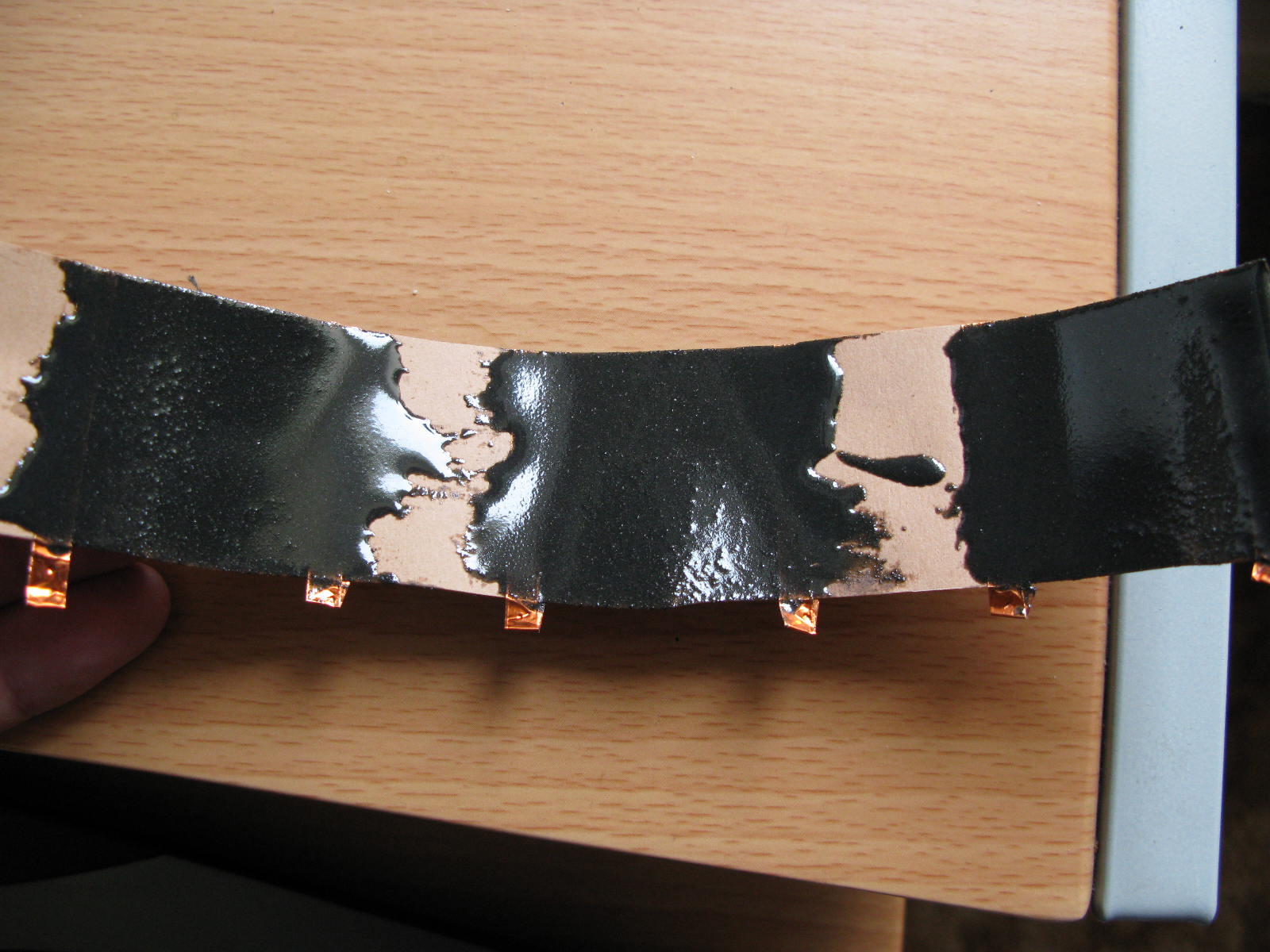

                Epoxy and 25% graphite
                Redid the paint test using epoxy.
                Three open circuits!
                Need a recipe !

                    try black liquid shoe polish
