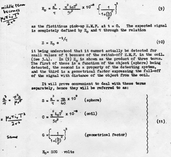

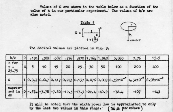

F B Johnson already won the prize in 1956.
Read the rest in the full Johnson paper in the Pulse Induction History thread. He does say that the results are affected by the finite size of the object, which presumably means the distance at which the 6th power law kicks in for a given coil radius.

He really deserves the posthumous Metal Detecting Nobel Prize (when I'm correct about his pass away).Originally posted by Ferric Toes View PostF B Johnson already won the prize in 1956.
[ATTACH]24941[/ATTACH][ATTACH]24942[/ATTACH]
Eric.
Hats off to Johnson.
