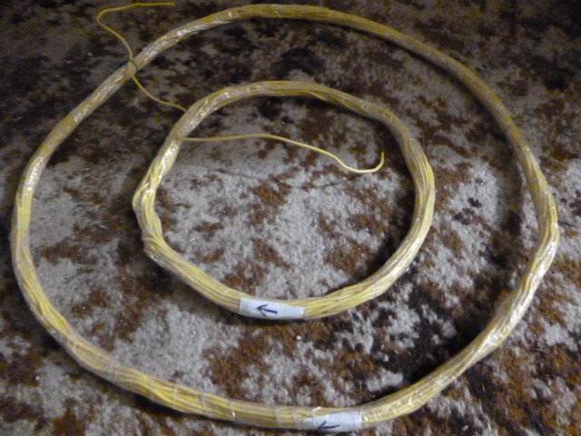

            i really want to make my second coil and i want to take a shot at making a dual coil...can anyone tell me if i wind the large and small coil as one coil or do i wind both
            separately then connect in series ?????
              Did you read the patent abstract?
              anyhow does this picture help ?

                if you make a dualfield coil use the photo from kt315
                connect both coils in serie (in same winding direction)
                to improve the simple dual field coil form the inner coil
                to a tri-spiked star
                you get a coil with sections of higher and lower magnetic field concentration
                it ist a good mix for ground penetration and small objetct sensivity

                  i looked at the patent diagram and it shows two damping resistors but the picture of the home made coil shows no second damping resistor...just two wires coming out of coil....i was wondering if its possible to use two different gauges of wire with this coil...like thinner gauge for smaller inner coil....what you think ????

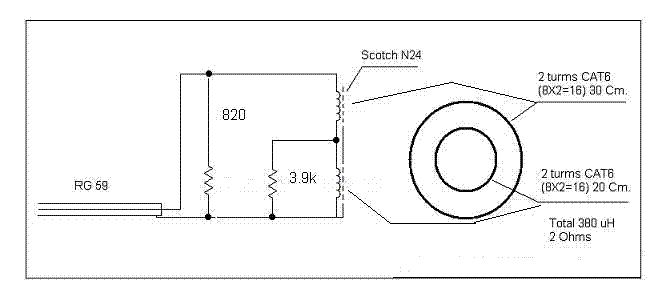

                          is the dual field coil one continuous winding or two separate windings then connected in series ??? i would guess the large and small coil would share the total inductance of around 350 uH ????
                            I performed the dual field coil as follows:
                            The two coils have the same number of turns.
                            A coil of 30 cm, 16 turns, and the other 20 cm diameter, 16 turns.
                            Both coils are in series.
                            The center coil leads damping resistance.
                            At the ends of the coil carries another damping resistance.
                            The resistance values ​​are experimental buffer.
                            The advantage is a better detection of small objects.
                            See the diagram below.
