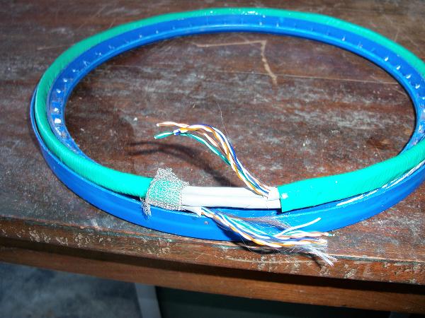

                im a bit confused about this cat 6 cable...i looked on ebay and it looks very chunky cable...whats the advantage of this cable ???? will 16 turns of this fit into coil shell ????
                  The cable used is Cat 6 or Cat 5.
                  This cable is used for data transmission, is composed of 8 conductors of 0.5 mm in diameter, in the case of Cat 6 the diameter is slightly larger, between 0.5 and 0.6 mm.
                  Another may use this cable between these values ​​(0.5 or 0.6 mm) corresponding to 23 or 25 swg of acuero to the table.
                  The blindage we perform with Scotch tape No. 24.
                  In the image below is an example of a mono coil.
                  JoseClick image for larger version

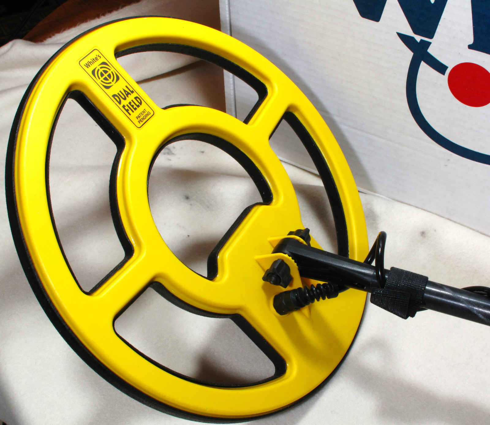

                    did anybody open this coil and has measured L of windings and damping resistors' value? daverave is looking for real data, not a fantazy.

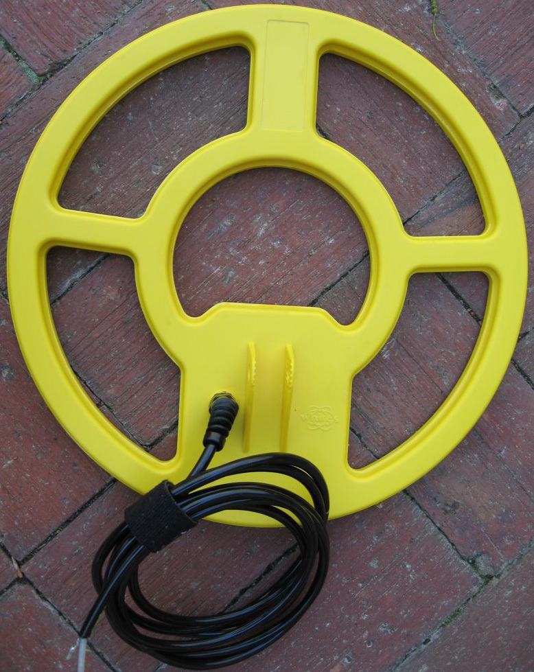

                      i am not sure if the original whites dual field
                      is really a dual tx coil (two coils in serie)
                      at the surf pi it is possible to separate tx and rx stage to receive lowest pulsedelay timing
                      if we could see the original connector plug we can discuss more
                      if there are 2 pins or 3 it is a simple coil
                      if there are more as three pins it could be a separated rx/tx configuration
                        on a photo above I uploaded you can see clearly one strande shielded cable and no connector used. a cable is connected directly to PCB.
                          i have to admit that the whites coil looks very impressive....thanks for the photos mate kt315.
                            im still very unsure about the construction of this dual field coil....what gauge and type of wire do i use ???? when i start to wind the coil around the nails of the 12" size...when ive completed one turn do i then wind one turn around the 6" size then back to the 12" then do this over and over again until the correct number of turns is completed ???? or wind coils separately ???? im just not clear in my head on this process.
                              wind coils separately. have to put a damping resistor to inner coil (according to the patent). as second dumping resistor has set at PCB, so no need to add this second resistor in a coil.
                                Separetely windings and serial connected between each other.
