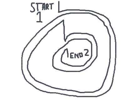

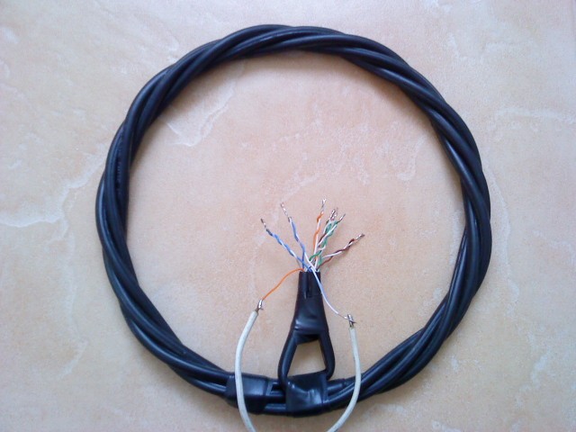

WHITES DUAL FIELD COIL
Cat5 like this.
serial connected between each wire.Attached Files

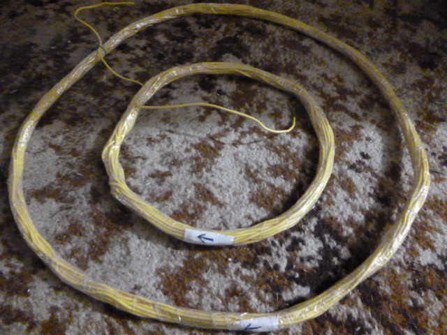

i have just wound a dual field coil as follows using 26 swg copper wire....(12 inch coil....18 turns 350 uH) (6 inch coil....18 turns 130 uH)......both coils in series 5.7 ohm....495 uH total....are these readings too high and do i need to remove some turns from these coils ?????
Hi Dave,Originally posted by daverave View Posti have just wound a dual field coil as follows using 26 swg copper wire....(12 inch coil....18 turns 350 uH) (6 inch coil....18 turns 130 uH)......both coils in series 5.7 ohm....495 uH total....are these readings too high and do i need to remove some turns from these coils ?????
you can calculate the required number of turns count with the measured data above.
As both coil parts L1 and L2 have the same number of turns count (=n) and the total coil inductance L0(n) is given (measured):
L(n*k) = L0(n)*k*k,
where L0(n) is the given inductance (495 uH)
n = number of turns count of L0 (18 turns)
k = turns count factor for desired inductance L(n*k)
k = sqrt( L(n*k)/L0(n) )
Let's say you want to have a 300 µH inductance and want to calculate the new turns count factor k:
k = sqrt ( 300 uH/495 uH) = 0.78
The new turns count would be n' = n*k = 18*0.78 = 14
Trivial math.
Cheers,
Aziz

This is Rovs coil , as in my picture.
make a 11 1/2 inch loop with 16turns of medium duty tin plated multistrand wire. will give you about 0.4ohms coil resistance.
next make a 6 inch loop for inner with 19 turns medium duty tin plated multistrand wire. this will give you about 0.4ohms coil resistance also.
wire these two coils in Series with each other,an now you will have a very deadly coil to use on your TDI or other PI machines.
Regards Rov
i did some tests tonight with the dual field coil and i found that i did not need to use a second resistor across the smaller coil as there was no ringing...i guess its because the coil is around about 5 ohms....i managed again about 12 inches on an old uk large penny...but only about 5 inches on a very small 9ct thin section gold ring...the small coil not very good on this ring....may i do need stranded wire and lower dc resistance.
