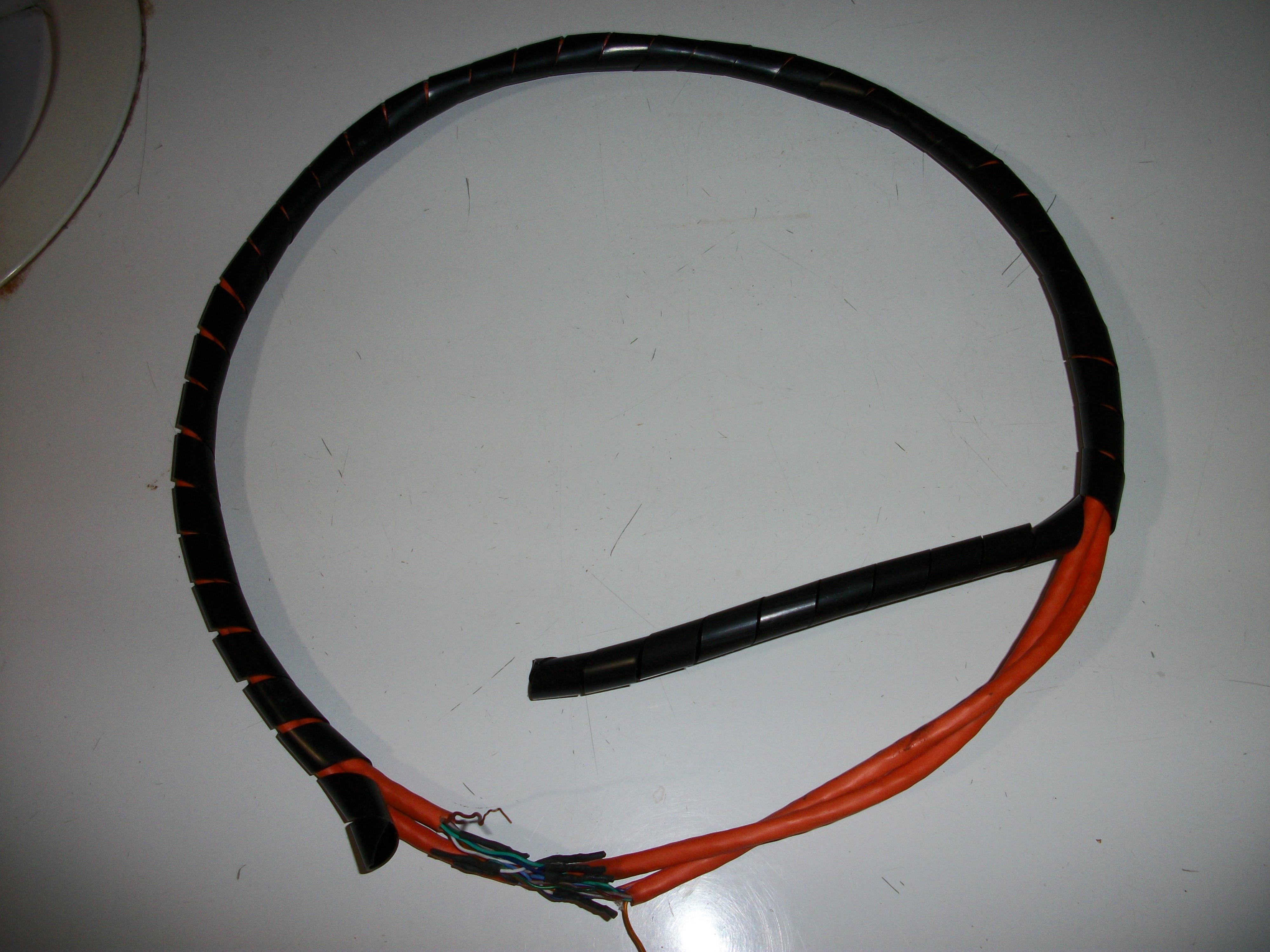

              • #67
                Coil Large: 12 inches, about 30 cm, 2 laps about 2 meters.
                Reel Girl 8 inches, approximately 20 cm, 2 laps, approximately 1.5 meters.
                Total cat6 approximately 3.5 mtrs.
                Attached photo of a coil, this cubhierta with plastic tape to give more to blindage separation.
                The blindage not seen in the photo.
                JoseClick image for larger version

                  • #69
                    Jose[ATTACH]27070[/ATTACH]
                    thanks for the photo jose that has given me a clearer view of what the coil should be like....just 3 questions....what is the inductance and resistance of that coil cause only two laps...and can the ends be soldered directy together ???
                    • #70
                      Daverave
                      The photo shows only one of the coils, remember that they are two and are connected in series.
                      The two coils are constructed identically, the only difference is its diameter.
                      The inductance of the higher coil is 175 uH and 1.2 ohms.
                      The inductance of the smaller coil is 100 uH and its resistance is less than 1 ohm.
                      Connected in series and the coil arranged girl inside the large coil, gives an inductance of 380 uH and 2 ohm
                      These values ​​are approximate, since my instruments are not accurate.
                      Do not understand the last question.
                      You can experiment with a single coil of three turns cat6, and diameter 25 cm (10 inches). You will have 8X3 .. 24 laps and an inductance between 300-350 uH with a resistance of about 1.5 ohms.
                      Also this type of coil is easy to make and you answer quickly, use less tin solder candidad possible so as not affect their response.
                      Jose

                              • #75
                                Do not know if Cat 6 is better than ordinary insulated wire.
                                A few years ago when you return to this hobby, I started with the Delta Pulse and coils did with cat5,
                                It worked very well and since then I use cat5 or cat6.
                                I will buy regular insulated wire to compare results.
                                Jose
                                in your photo you show the ends of the wires joined together with heat shrink....why is that ???? ive ordered a 10 metre cat6 cable...can i just wind three 12 inch turns then solder the 8 wires together on each end of the coil ???
