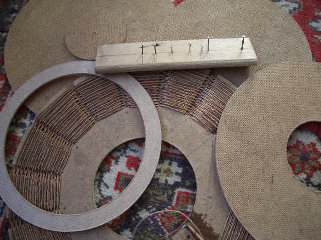

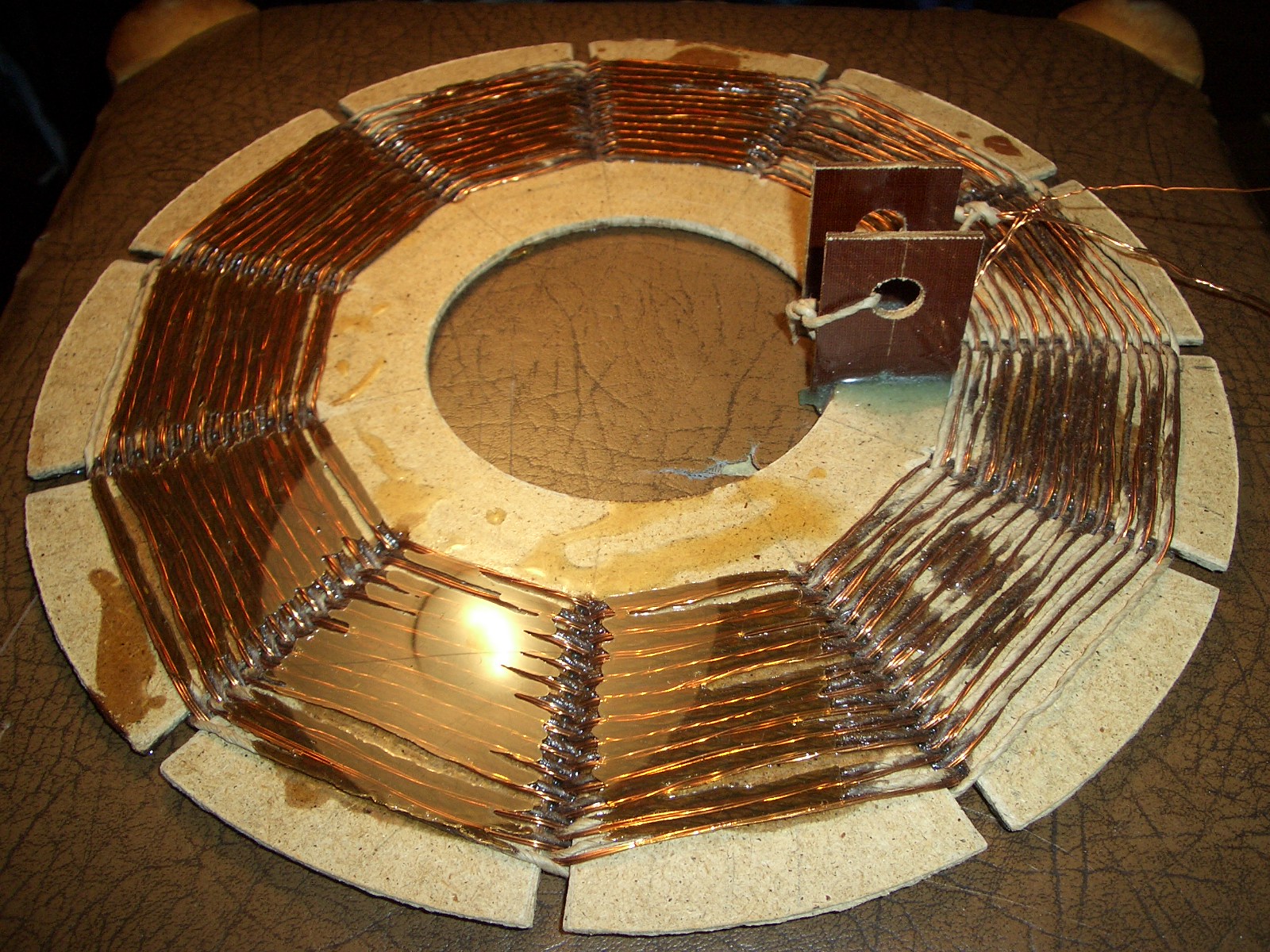

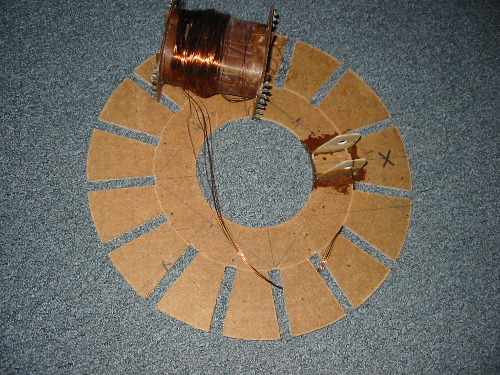

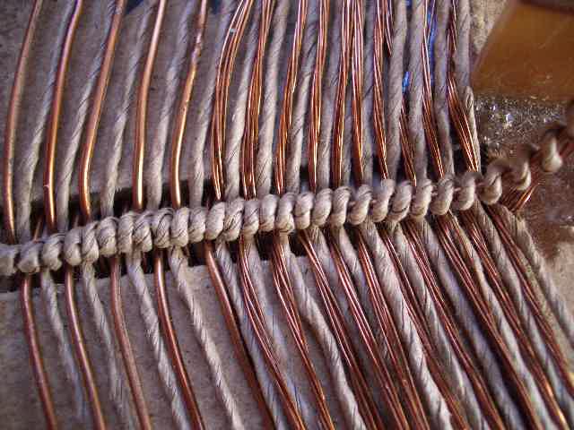

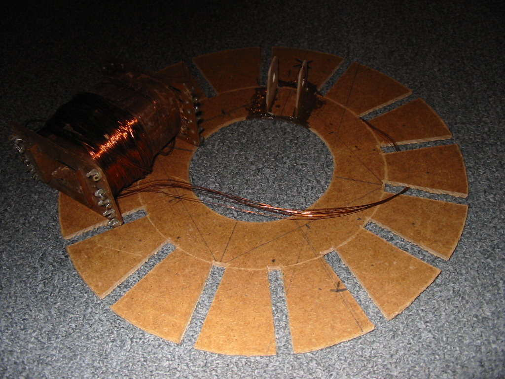

                  you can do litz yourself. take 0,3-0,2 mm insulated 3-4 wire and spin them together. yes, it is not so easy work, yes, it is not so productive work, but you ask
                  about litz. I did go in wood, stretch out a wire between trees... so I got 30 meter of litz.
                    this is litz and this is a basket coil.

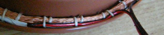

                      yes, or this "no basket" example usual Litzing wired coil version:
                        i wrote BASKET coil! if you mean TO MAKE THE LITZ so why you do ORDINARY COIL on litz??????? for the ordinary coil you use ordinary wire and leave the litz!!!
                        LITZ ===>>>>> BACKET COIL ONLY====>>>> LOW IMPEDANCE ====>>>>>> WIDE SPECTRE RADIO FREQUENCIES

                          hello kt315....whats the advantage of your basket coil ???? pls can you tell me if stranded wire has to be insulated every wire for it to be used in a detector coil ????

                            traditional Litz wire was made from individual insulated wires soldered at each end. It was made mainly for radio applications.
                            here is a video showing one way to make it.
                            http://www.youtube.com/watch?v=LWL8qGCeTJA
                            (In some country's, and I dont know why,
                            but multi strand uninsulated wire such as speaker wire or radio hook up wire is sometimes referred to as litz wire.)
