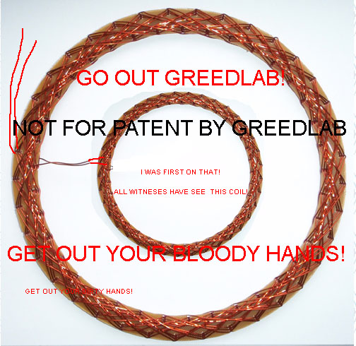

look here a basket coil pics http://www.metdet.ru/Sensor_K1.htm

what you want to get from coil? you want do whites dual field one or PERFECT COIL? thinking you want PERFECT COIL primarily. perfect coil is ONLY BASKET COIL, more perfect is SPLITTED basket coil in 2 part - inner and outer windings.Originally posted by daverave View Posthello kt315....whats the advantage of your basket coil ???? pls can you tell me if stranded wire has to be insulated every wire for it to be used in a detector coil ????

When you compare a simple bunch wound coil to the basket weave, Certain simple designs of basket weave can reduce the capacitance of a coil. Like in post #16, the text suggests this type of weave makes a faster coil.whats the advantage of your basket coil ????
whats the advantage of basket coil....have you a photo of completed coil ????Originally posted by kt315 View Postwhat you want to get from coil? you want do whites dual field one or PERFECT COIL? thinking you want PERFECT COIL primarily. perfect coil is ONLY BASKET COIL, more perfect is SPLITTED basket coil in 2 part - inner and outer windings.

Don't waste much time on this, home made Litz-wire etc. Many times discussed here. Larger diameter individual strands will not produce noticeable effect, true Litz is made from 0.032 or less diameter of individual wires, impossible to made manually in 20m length. Basket coils are fine and fast, just shield will completely “kill” them, this type of coil, with low capacitance and dumping R nearly 1Kohm, unshielded is very sensitive to ground (capacitive, not GB) effect, shield will slow it down significantly, no matter how it is applied. No need for teflon insulation, PVC will do the job, difference in E0 is not that important, more mechanical spacing between wires to reduce self-capacitance. Try flat spiral speaker wire design, cheap and fast, easy to made.

Coil “speed” is not about number of strands, more about insulation (distance between wires to reduce C, basket shape helps wit this, most insulation is air but shield will screw it up) and amount of metal (coil own eddy decay), 0.2mm is too thin to achieve low enough resistance, below 2R. Stranded wire, if not true Litz (each strand insulated) also wont help much. Some experimenting will, adjusting minimal sampling delay and appropriate Rdump value for given coil is necessary, all gain come from this
