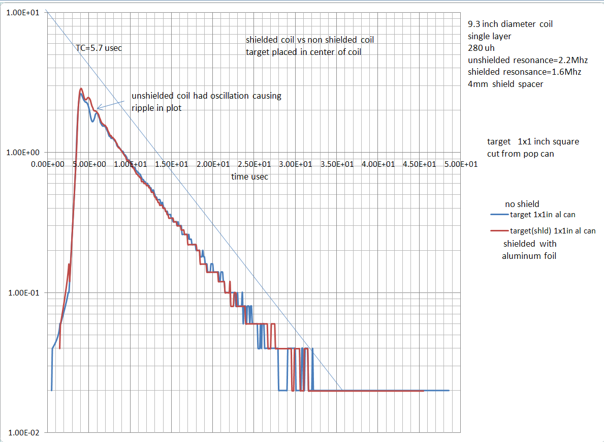

                  Don't have any graphite so I've been using aluminum foil for the shield. Was wondering how much signal loss I am getting. I have a single layer coil wound on a wood hoop. Recorded target with coil not shielded and shielded. The plotted data is the difference of a no target recording and a target recording. Didn't see much loss.
                    Aluminum foil acts like target. May be signal of it is not too strong so you can not see it on chart but it is here.
                      I think another way to test the effect of your shield is to do an air/detection distance test with a much smaller and thinner target (perhaps 1/2" X1/2" X .001" thick) with the coil unshielded and shielded. Don't know if it is possible for you to remove the shield or not at this time. This test would give a real world idea of shield degradation of detection distance.
                      A few years ago I shielded one of the first spider coils with 0.001" thick copper foil and it was 'really pretty' but destroyed the coil sensitivity and speed. While aluminum foil decays much faster than copper foil we know from our 'Target Time Constant' thread tests that even very small amounts of .001" thick foil will be detected at short delays. I would think that the effect of your aluminum coil shield would make it hard to sample at short delays because there is a relatively large amount of it whose decay masks desired fast target responses.

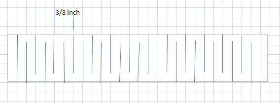

                        I will try the 1/2 x 1/2 foil shielded first to see how fast I can sample. The coil was over damped on the first recordings. Wanted to keep the amplifier the same and didn't know how much adding the shield would effect things. The amplifier comes out of saturation at 4 usec after gate off signal with shielded and unshielded coil. Not sure why target size would effect when it comes out of saturation unless target signal is too strong. I bought a large spool of awg 28 magnet wire a long time ago and am trying to learn with what I have. I cut the foil before putting it on the coil. Thought I saw it somewhere on the forum but can't find it now. Maybe not. I put 2 inch masking tape on the foil long enough to go around the coil and cut it for desired width. Then mark the tape every 3/8 inch. Cut on marks from one side. Turn tape around and cut between cuts from the other side. 3/8 inch seems to work, a different dimension might work better. The thread was about signal loss and I didn't see any. I tried only one time, maybe If I tried again it would be different. I would be interested if graphite effects the signal. I think it would be a lot easier and faster to apply. Picture included
