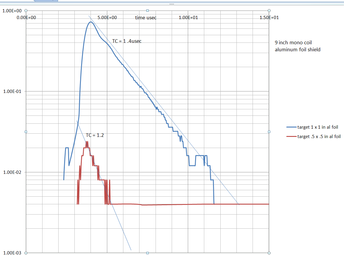

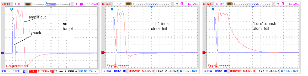

              I recorded more data. Still 4 usec delay. First image is 1x1 and .5 x.5 inch aluminum foil. Second image is scope screen trace of amplifier out and coil fly back with different targets. Still getting some noise glitches from the circuit but the trend should be correct.

                Interesting that 12x12mm (0.5 in) piece is detectable. Probably 8x8mm piece will be invisible for this detector.
                How about unshielded coil? Is there any difference?
                What wire you have used to make a coil? solid or stranded? What cable used to connect coil solid or stranded?
                Also on second picture it looks like coil is ringing too much.

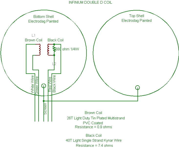

                    Try awg 28 stranded insulated wire for the coil. Magnet wire is good target also thin lacquer insulation on magnet wire perfectly builds capacitors in places where wires touching each other.
                    Many expensive PI MD using stranded insulated wire for the coil
                    For example Garrett Inginum LS: Click image for larger version

                      For example Garrett Inginum LS: [ATTACH]29083[/ATTACH]
                      I have had only mediocre performance in coils wound with enamel insulated solid conductor magnet wire…speed always suffers.
                      There is a significant difference in using either PTFE or TEFLON insulated stranded wire and it is even better to use the 600V rated insulated teflon…thicker insulation is better. I wound a coil a few years ago with 26 AWG stranded PTFE 250 volt insulation and it does not perform nearly as well as the 600 Volt stuff. I just received some 26AWG and 28 AWG stranded wire in 600V PTFE insulation. Will be using it to wind an elliptical spider coil. Not sure if the 28AWG will allow enough current for best detection. Will post elliptical coil performance in the coils forum.

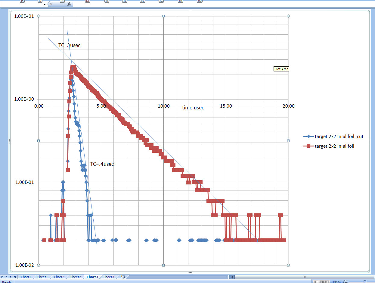

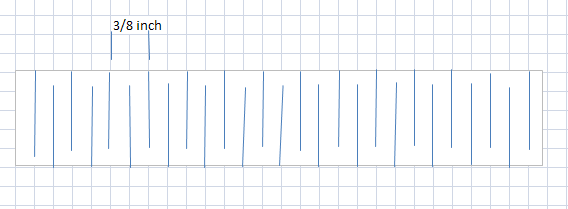

                              Not suggesting aluminum foil is the way to go. A plot showing why I think it didn't change the 9 inch coil sensitivity. First image is a 2x2 inch piece of aluminum foil not cut and cut in a pattern shown in second image The cut foil has a TC of .4usec vs 3usec for the not cut.
                              • #45
                                Cutting is a great idea!!!! Thank you!!! Should be used widely in such construction with different shield meterials.
                                I am not suggesting aluminum too also because of corrosion of aluminum and bad contact to cooper wires.
