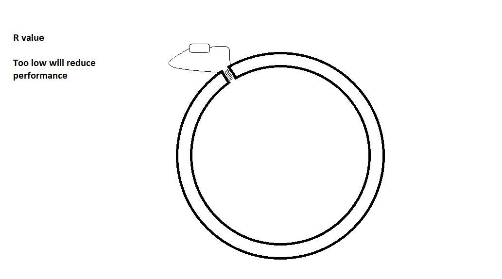

    • If one had a metallic sheild and new what the air distances were. The user could add a resistor across the end / gap -- when the R value got too low the distance to detect would suffer.
      This isnt quite the same as discussed but may give first order pointers. S

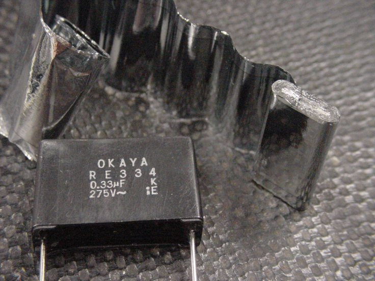

        On my VLF coils I'm getting good results using mylar from inside large capacitors. I'm not sure if they are Polycarbonate, or Polyester. I'm using some from work that were being tossed out. They are X2 caps, so they are designed for mains voltage which is 230V where I reside, and thus have high insulation resistance. Which seems to mean that the mylar is a reasonable thickness, in fact it is almost see through, but much thicker compared to low voltage types.
        In these caps the layers are twinned up so I first separate them and then wind one layer on the coil conductive side up, and then do a second layer conductive side down which overlaps the join of the lower one. This gives around 50 Ohms per inch, which is way below George Payne's recommendations, but since the current has to wend its way around a maze of curls and turns it seems to not generate much of any extra noise in the machine.
        Worth an experiment anyway, it may just give you a real hot loop. One things for sure, it makes for a very fine screen, much better than cooking foil, which I believe along with others here, causes way too much signal attenuation.

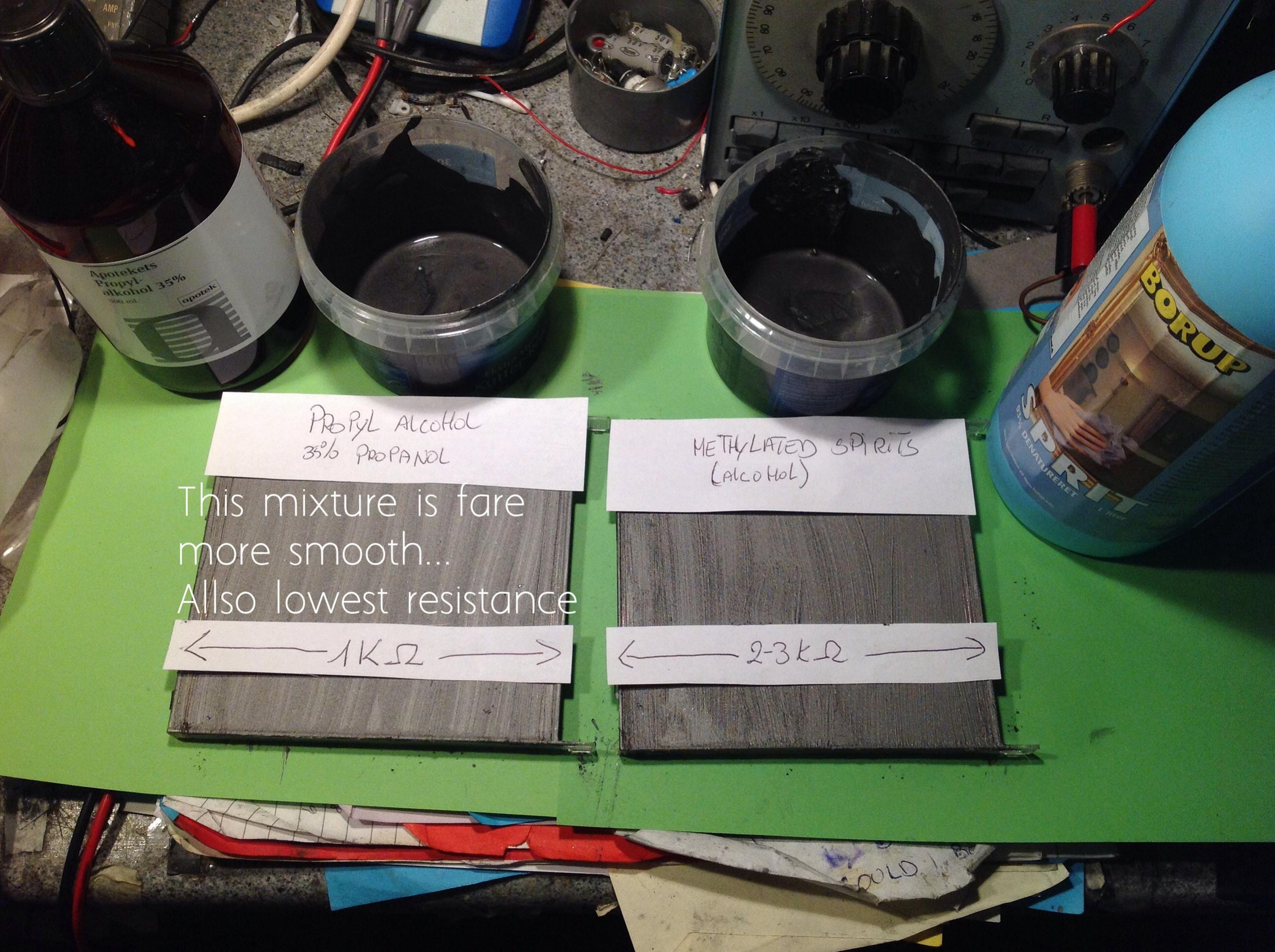

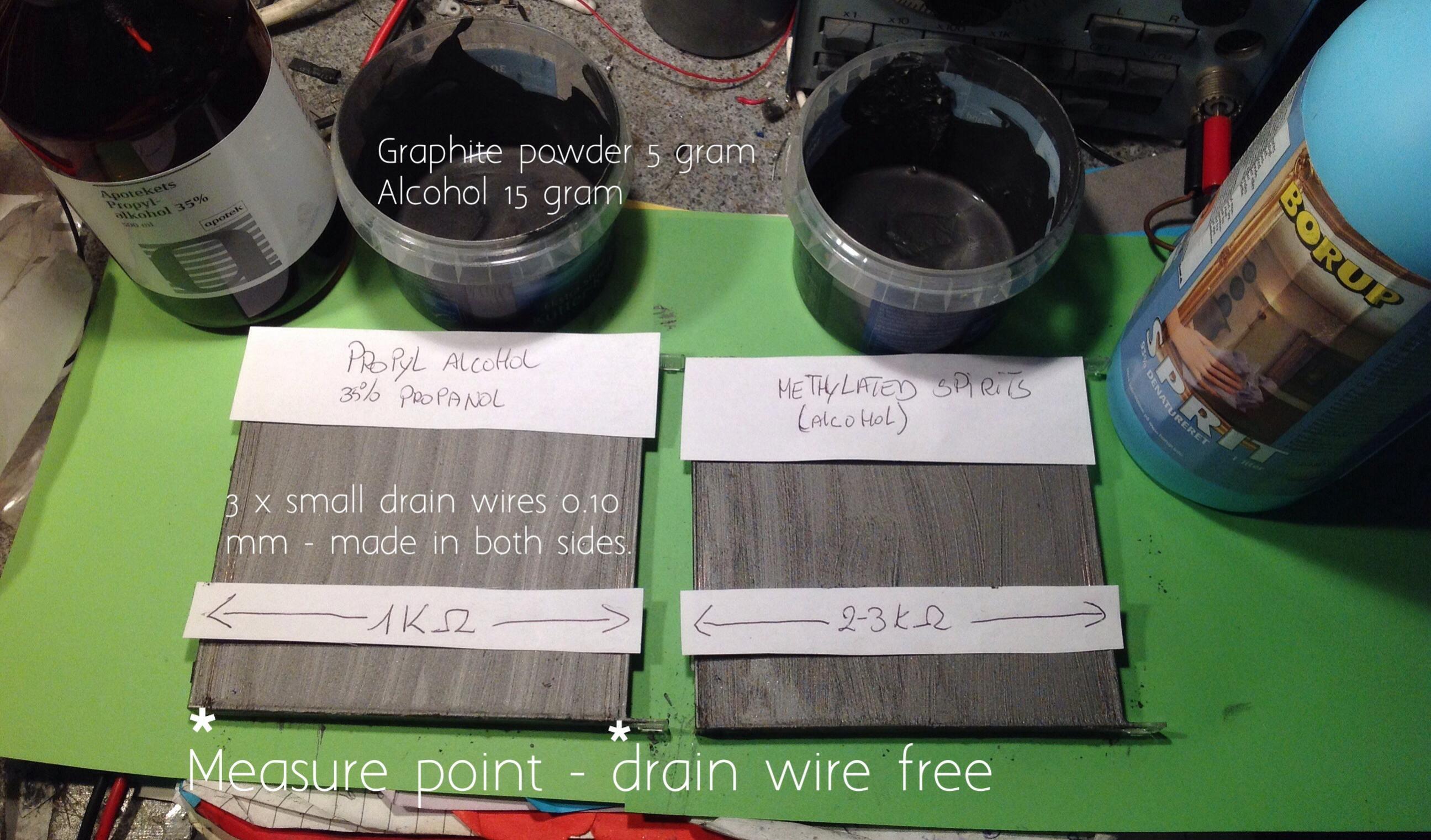

        • Graphite test
          Made a small test... See pictures.
          I a CD plastic cover, clean first with acetone, then one lay with the mixture. And wait 5 hours to it dryed up.
          I made 3 drainwires at the left and the right at each CD cover.. (Same type I'm using in the coil work)
          This alcohol I got is buyed in a drugstore, ist used to clean Medical tools, but I Allways used it to clean good old VHS videos videohead. It seem to make the mixture nice and smooth.
          They could Be some other types of alcohol getting the same good results. !!
          Its a good idea to use a brush with many hairs... To stiff brush will not Be good.
          Henrik.

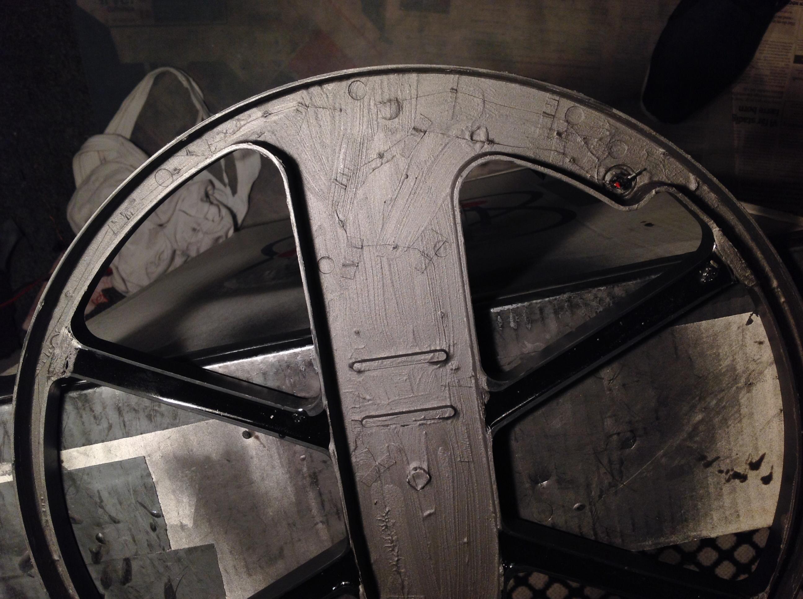

                    Just made the shielding at a 15" coil inside with my own mixture - graphite powder and propanol alcohol. - Looks nice.
                    Not proper dryed up yet to measure. Looks like low resistance, I like that.
                    Henrik.
