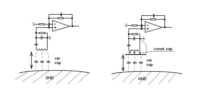

                      • It seems to me that electrostatic shielding (ESD) to prevent false signals from being discharged is important in both cases (PI and TR-IB), but it is more important to limit and stabilize the variable capacity that appears between the coil and the earth during the probe movement. The capacity affects the time constant in PI detectors and the amplitude and frequency characteristics (resonance) in the TR-IB detectors. The material from which the screen is made should have properties such that it does not generate too large eddy currents (average conductivity), decisive for the loss of energy but at the same time would be an "effective capacitor electrode" between the receiving winding and the mass of the detector.

                            • I present (I do not know if it's right) the illustration of what I wrote earlier, but when it comes to the conductive screen, in two attempts I managed to get a mixture of solvent-diluted wood varnish and powdered graphite, which, after a little careful application and drying, has resistances in depending on the thickness of the row layer 0.5 ... 1.5kOhm between the points of the meter spaced apart by 1 cm. The attempt to mix graphite with vicol wood adhesive, which is a water dispersion of polyacetate resin, ended in failure - the layer after drying almost does not conduct electricity and has a resistance of 20..35MOhm / cm, and polishing does not reduce this result. In the next step I'm going to apply a smooth, even layer with a paint roller and check the effect of detecting it with a metal detector.Click image for larger version

                                It could be but I think we need to avoid Eddy current flows into the shield; this is the main goal. Shield material should not interfere with the EM field. It's make like a capacitor armatures; that are made always of a good conductor!
