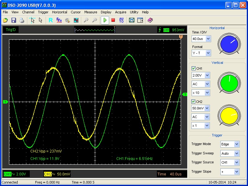

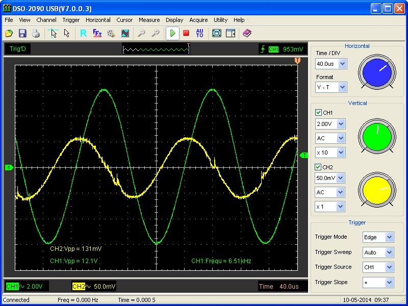

    I did this today.Preamp output :Pre AND Post applaying Graphit 33 Spray on coil.
      Originally posted by akasyto View Post
      Ok here is the DD27
      So you have a slightly different phase relation here, this is all the issue is.
      The option are - while viewing this osillogram... and waving ferrite / adjusting GEB pot... when you get rid of ferrite beep - phasing is correct.
      1) move the physical location of the Rx coil WRT the Tx coil in the shell - if potted you missed a trick and too late..
      2) Try a peice of ferrite on the shell to see if you find a location that give correct phasing, glue it there..
      3) Add or remove Rx cap value in 1 or 2nF steps, the amplitude AND the phase alter.
      4) Tweak the Tx cap value to see if the phasing alters favourably.
      Or a mix of all.
      Do you get single beep on pass?
      Do you reject ferrite on DD and Concentric?
      1) is favoured, others less so
