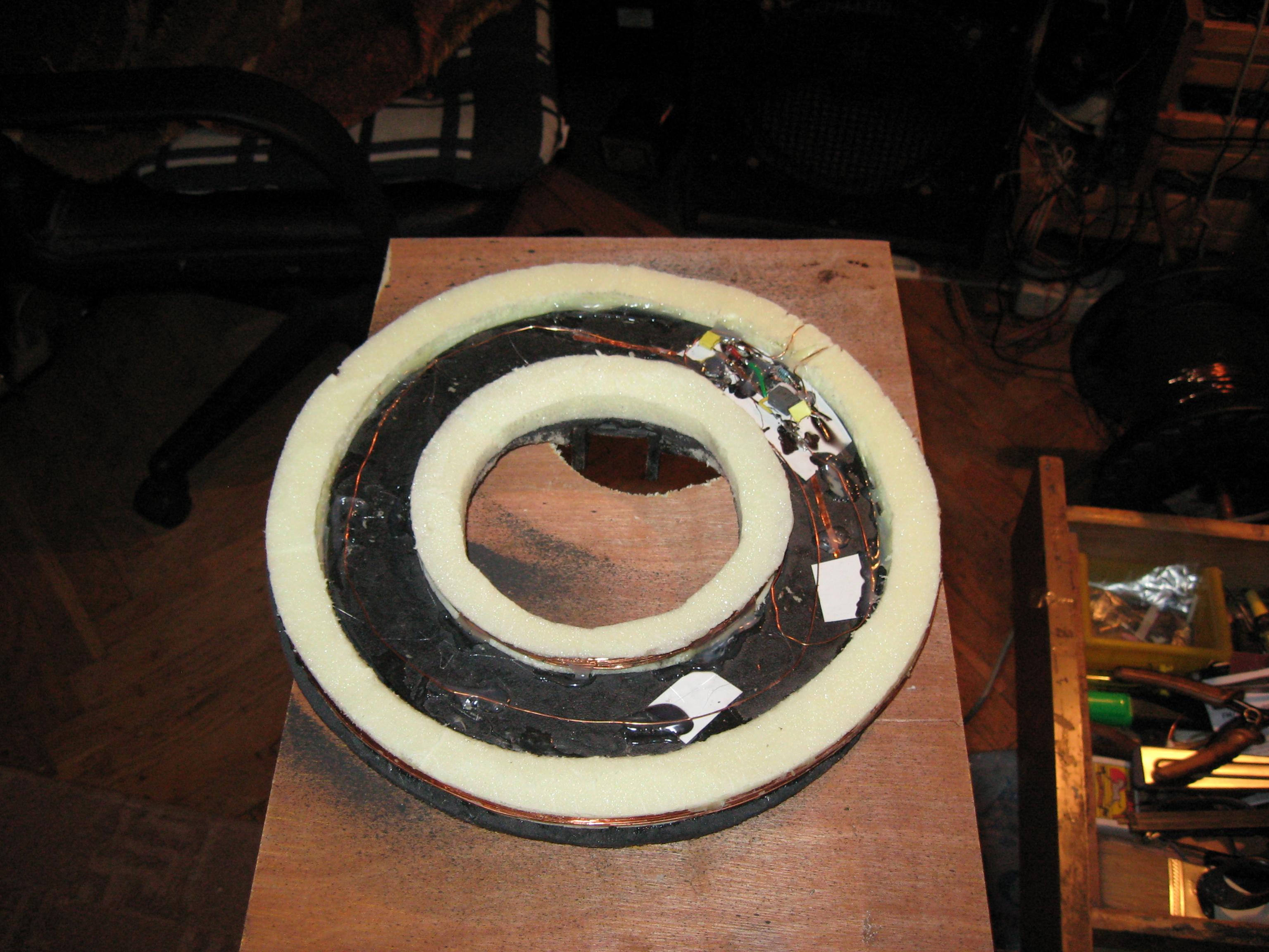

    My DD27 is not working very vell so i make 25cm concentric, .
    what goes wrong with the DD ??
    Do you know the machine is good ??
      discrimination was bad,i think machine is ok.Detecting 1 euro coin on 32cm in air with this concentric.

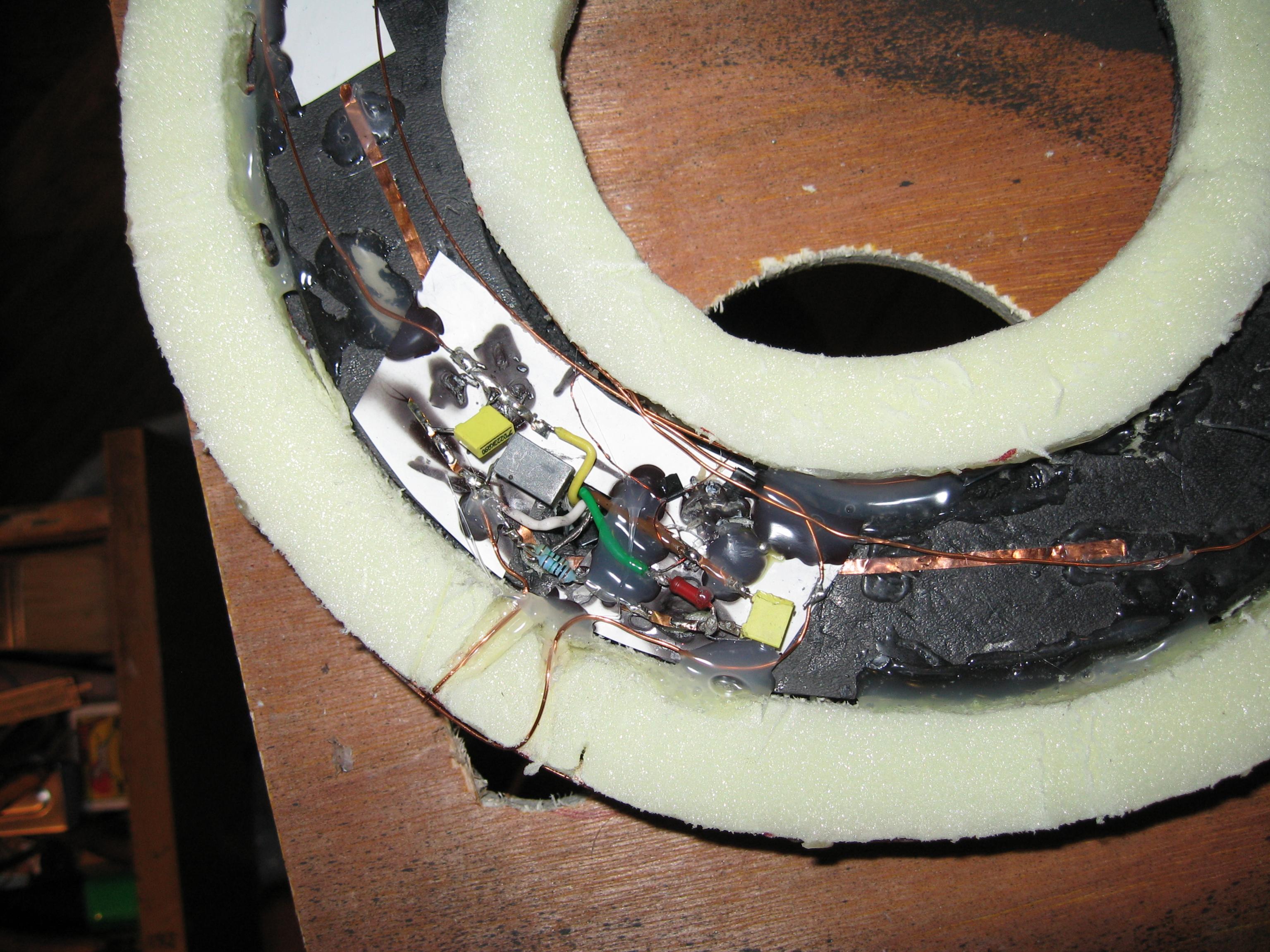

          I make it like that:
          30T TX 10T Fb 0.65mm wire 1uF+22nF capacitor
          310T RX 0.19mm wire 33nF

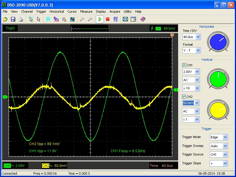

                    This is the oscilogram of my 8" concentric coil.

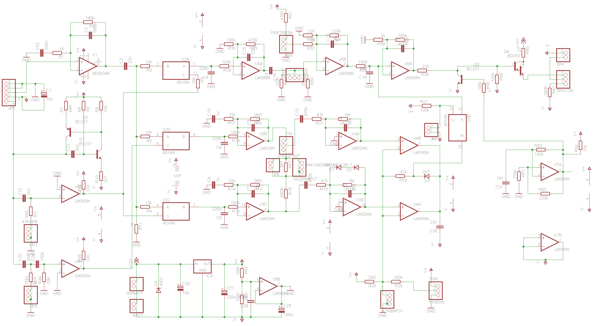

                      My schematic with all mods.

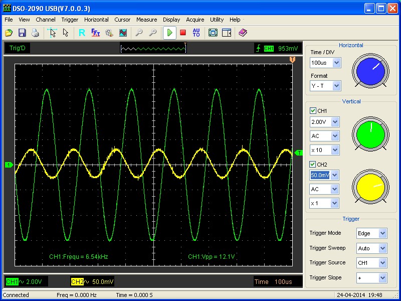

                        put the scillogram up for the DD so we see whats different.. S
                          Ok here is the DD27

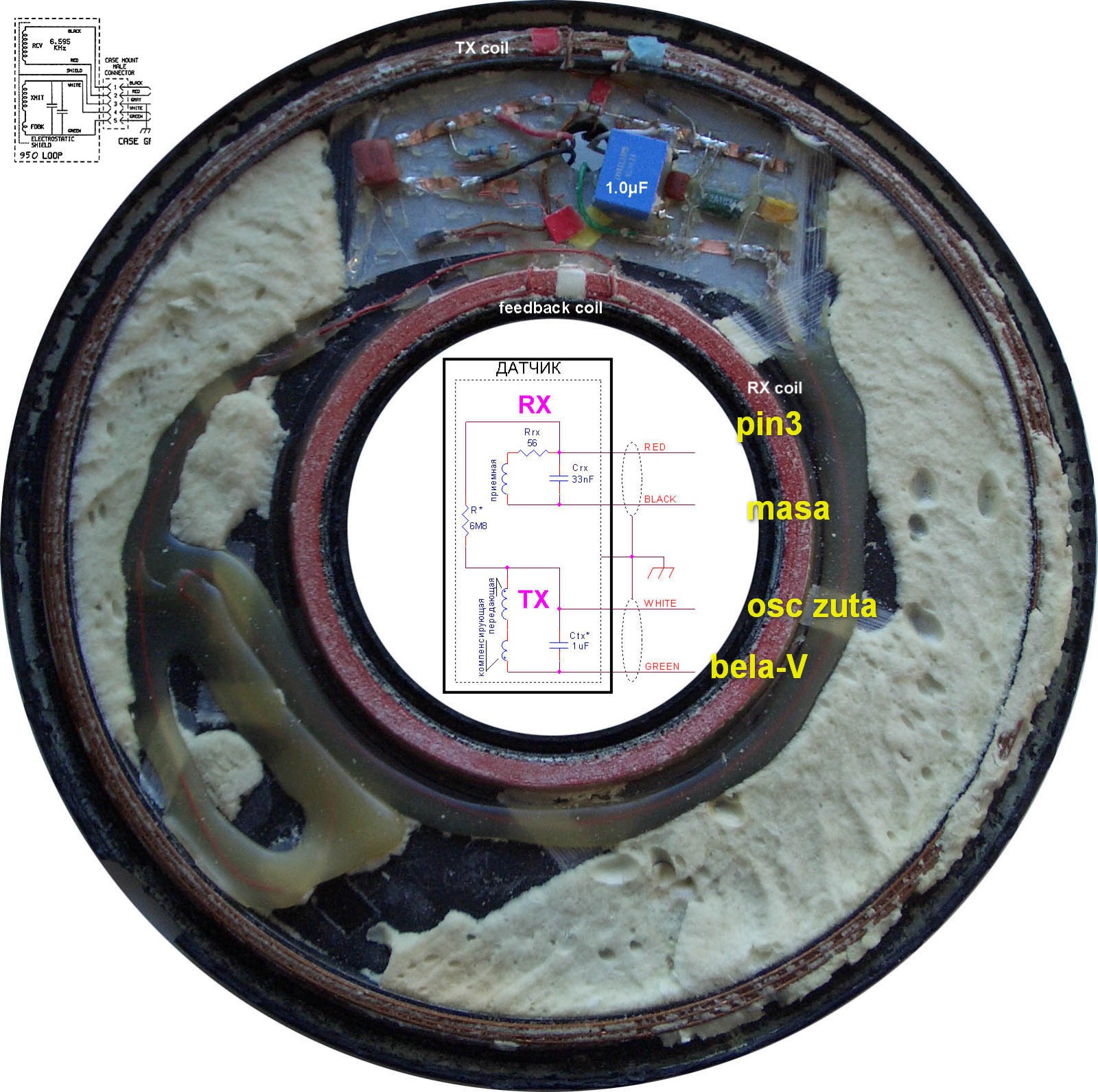

                            at left top corner of the pic I took a diagram from 5900 di pro schematic. it is NOT IMAGING real state of coil.
                            real coil schematic is ANOTHER, that I did draw in the center of the coil, center of the pic.
                            remember this moment.
