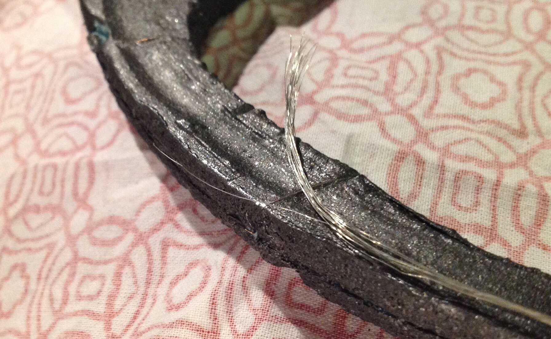

    I will post some proof to you. A drainwire will help a lot to get a even surface / resistance graphite lay. With out drain wires the lay will be thick and difficult to make same thickness everywhere, in corners and at the side. This spiral is a good idea.. Here is a test with the 13" Vista coil this evening. http://www.youtube.com/watch?v=SnmLMC5YNec&sns=em http://www.youtube.com/watch?v=SnmLMC5YNec&sns=em
    Picture 1 is the Vista Stock coil with spiral made drainwires... Thickness 0.15 mm cobber.
    picture 2 is a macro FOTO of the thin wires 0.05/0.06 mm I using.

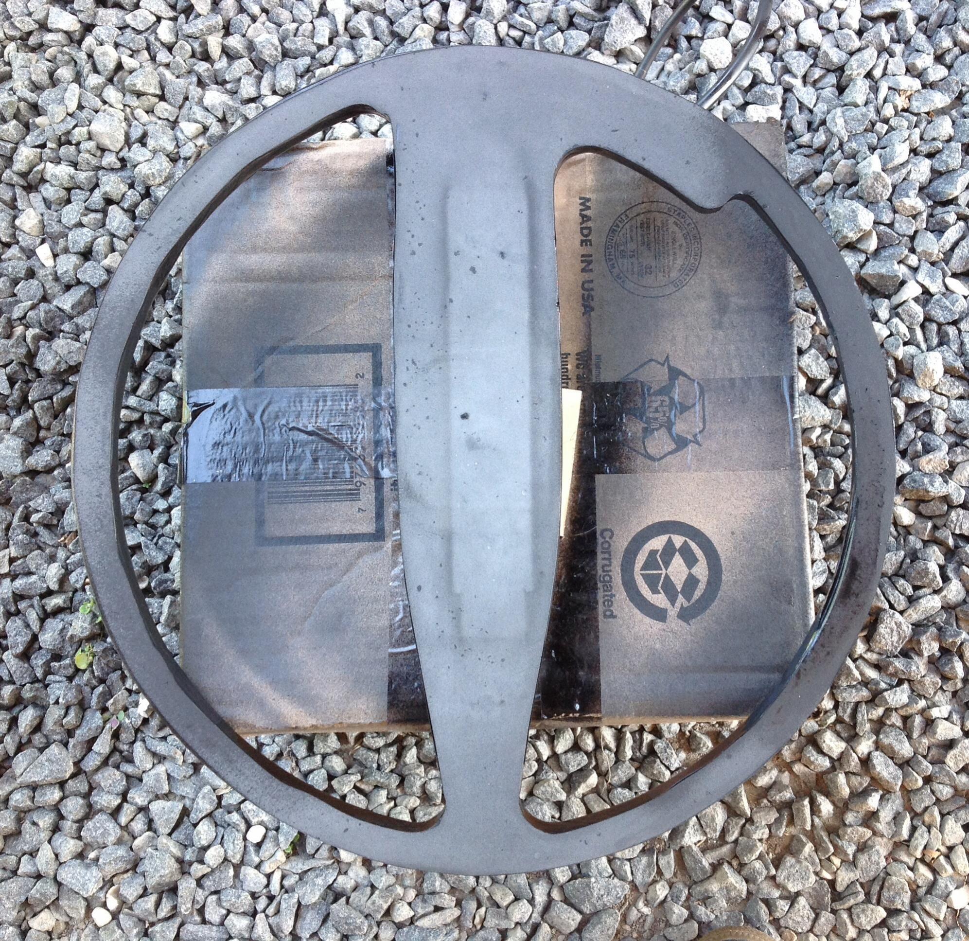

      So fare so good ... My 15" Deus coil got a new shielding this evening. Maybee you saw the coil clean, ready to get painted..( Picture.) My mixture with acetone, powder and lak was sprayed in a medium lay, then I used a Big brush to make a smooth surface and removed lose dust, before I finish with the protection lak.
      Back to the workshop and do the same airtest, same way I did some days ago, where I vs the Big Stock coil. Result was like hoped, I got a little more sens. and depht.. The measured resistance at the graphite was 3-350 ohm (measured before the finish lak) Very close to my goal... The earlyer made Sheilding which I removed went down to 100 ohm even a little lower at some places, and that was properly why there wasn't much advantage in this Big coil... Now the result was better.
      My way to test this, is the maximum distance where the ID is stable, and I got now 1.5" inch more with my Home made 15" coil.
      In the same time I was working with the Sheilding, I removed some weight... The coil is at 690 gram now and I only need some more lak and protection. Not bad If it ends arround 720-730 grams. The Big Stock coil is allso +700gr

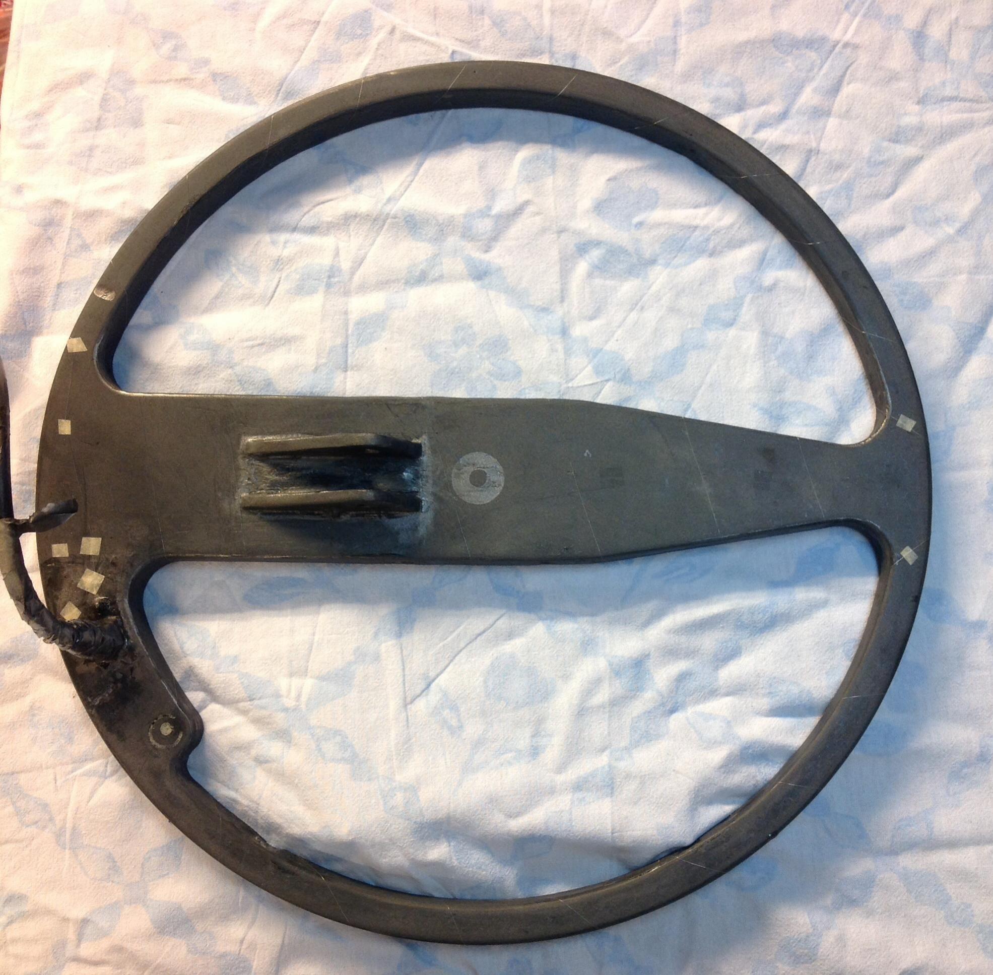

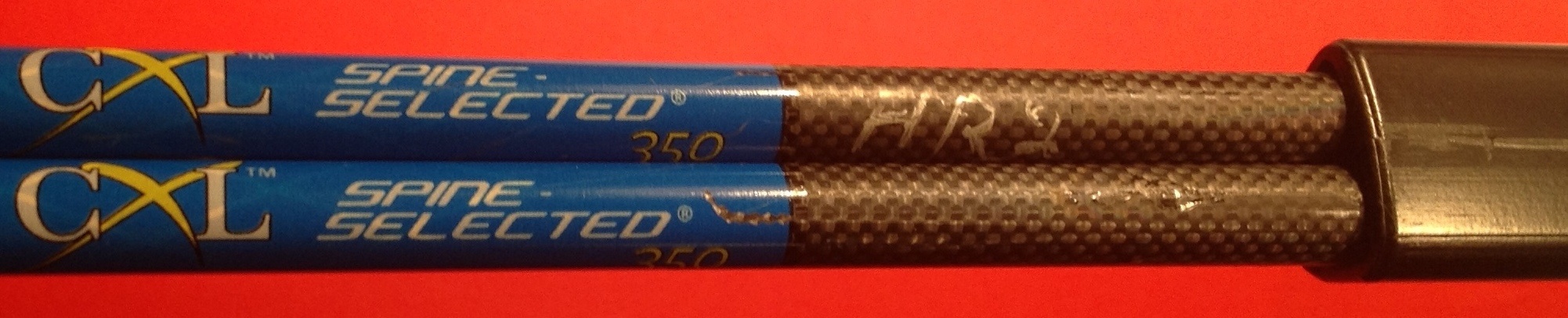

      By the way... Did you see my lower stem improvement to XP Deus.. If you had a Deus in your hand with the Big Stock coil, you would know that its shakes... Picture 2. Two Carbon tubes 9.10 mm fits perfect in lower stem...

            Those Carbon tubes are from my Archery Compound bow.. I had to Press them with force to get them down in the stem..
            2 x 9.10 mm was perfect. Another solution could be made, but this was easy and fast. Weight + 15-18 gram, both tubes.
              yes very nice solution, stiff srong light and not seen by detector...

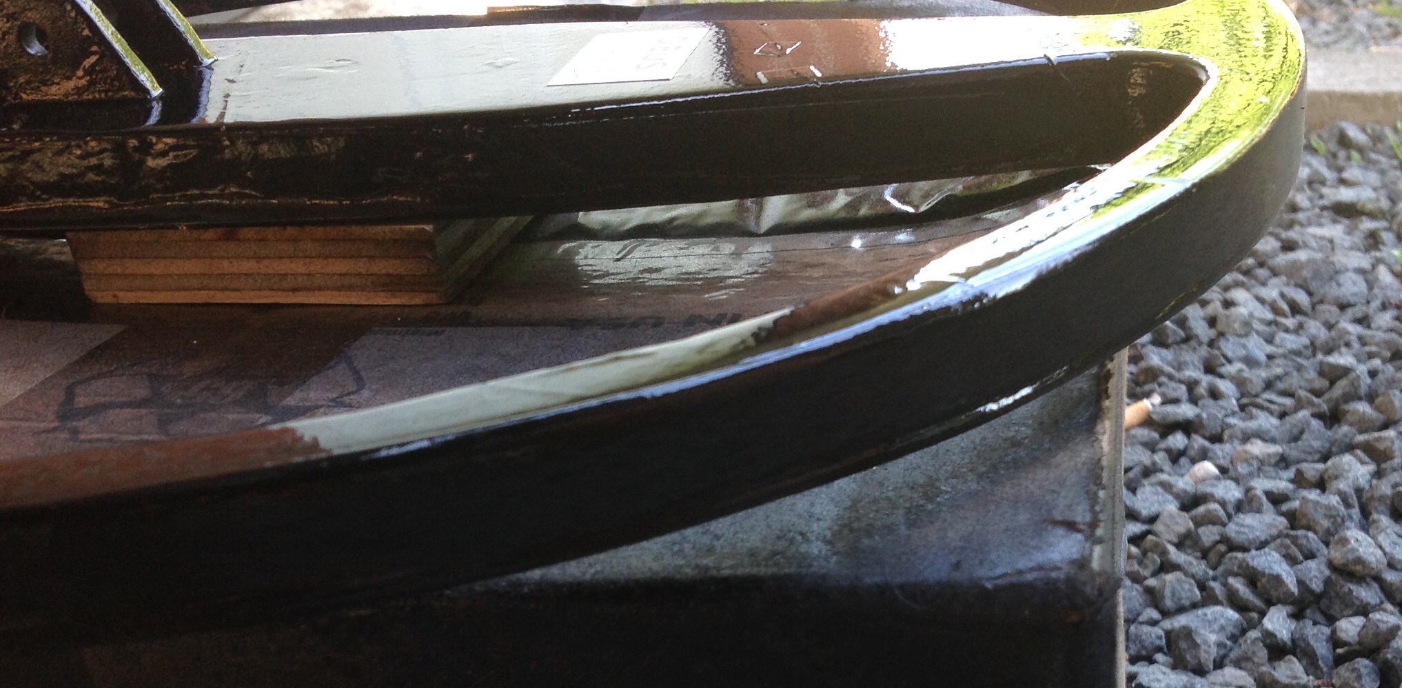

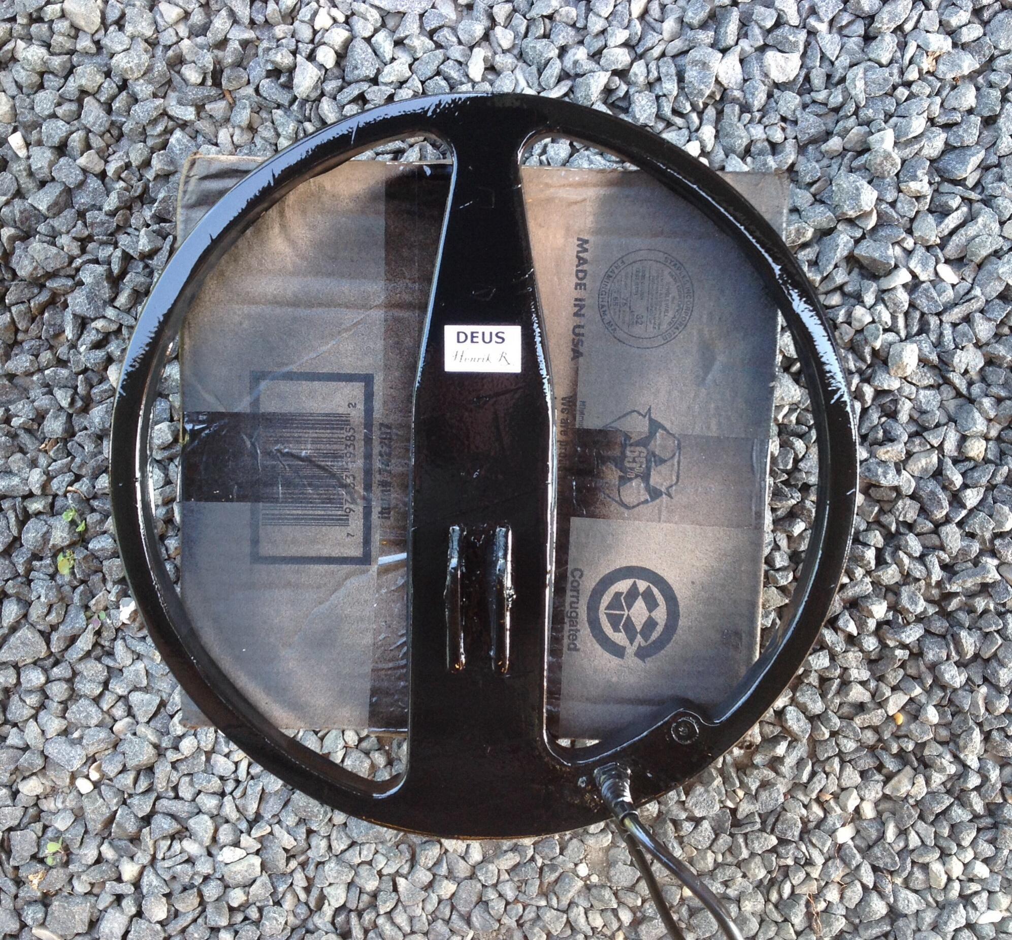

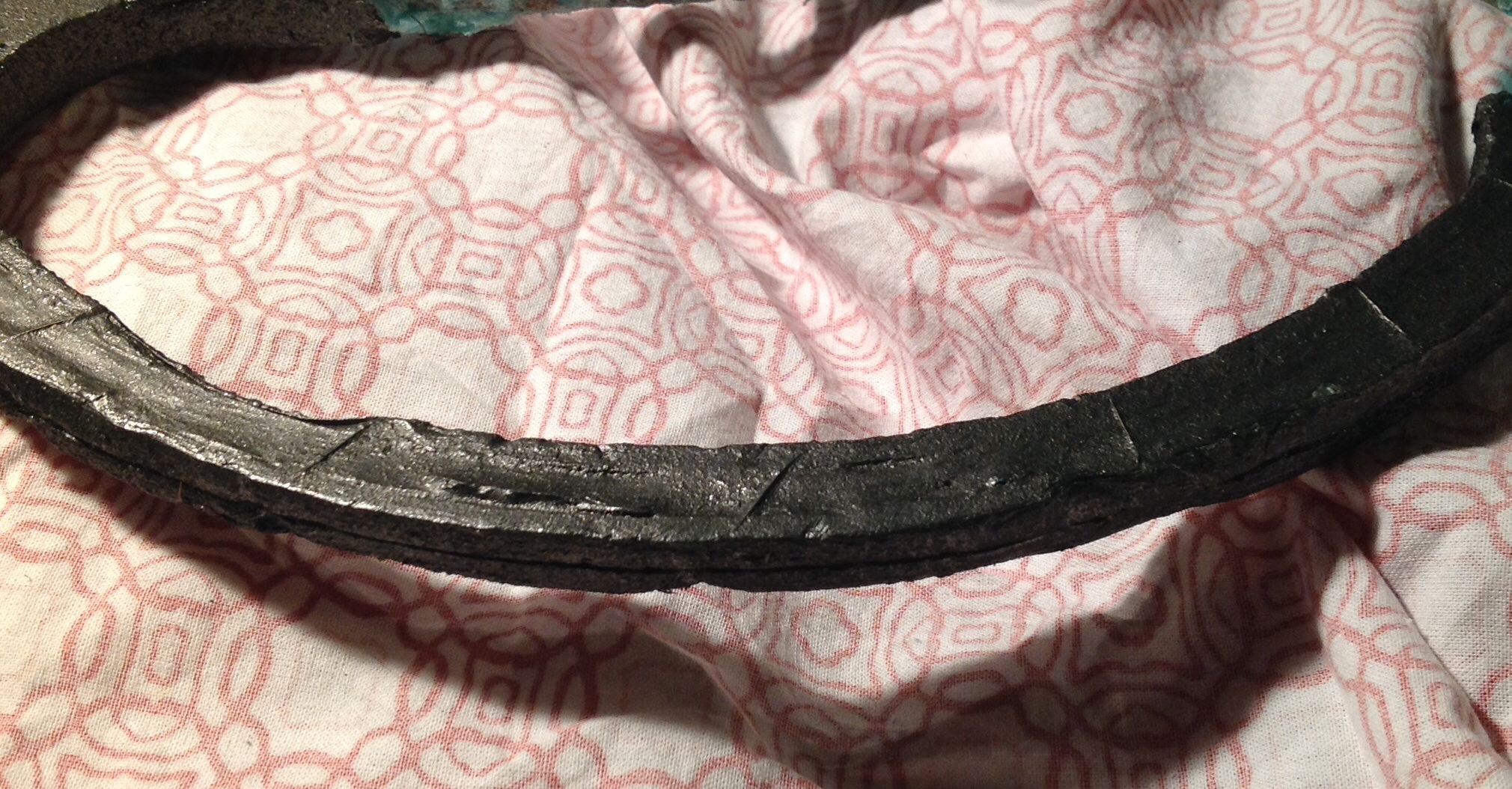

                  Ps. Pictures / the coil is drying up after lak, tape and protection... Ups. 745 gram. The bottom lay took 30 gram extra.
                  Side picture to see this rubber tape I'm using to seal plugs at my satellit dish work..
                  Bottom picture.. The drainwire is Secured behind this resin bottom lay.
                  Henrik.

                              I have to admit that this 15" project didn't end like I hoped. All kind off test is made and it isn't better than this largest Stock coil.
                              The project gave me some more coil building exsperience and now the coil is hanging at the Wall in the workshop.
                              Thanks for all the help you gave me.
                              Building a coil with high sens. to find deep targets is Very difficult, everything shall be 110% perfect and I don't got enough experience / knogled and tools to do this. Maybee in the feature I will try Once more, but now I realize that my limit is found.
