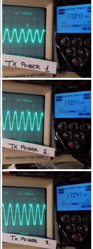

          But... the XP Deus has this feature as standard, I believe. There's three power levels, intended to make the most of the available small battery. And reports from those who have tried it suggest there's no difference.
            Just excatly Skippy no different in the field with TX 2 or TX 3 at the Deus, only that the Battery goes empty faster.
            TX 1 can Be measured with a little less depth. Picture was the scope work with the Deus 11x13 Stock coil.
            TX 1 = 10vPP / TX 2 = 15vPP / TX 3 = 18vPP
            Henrik.
