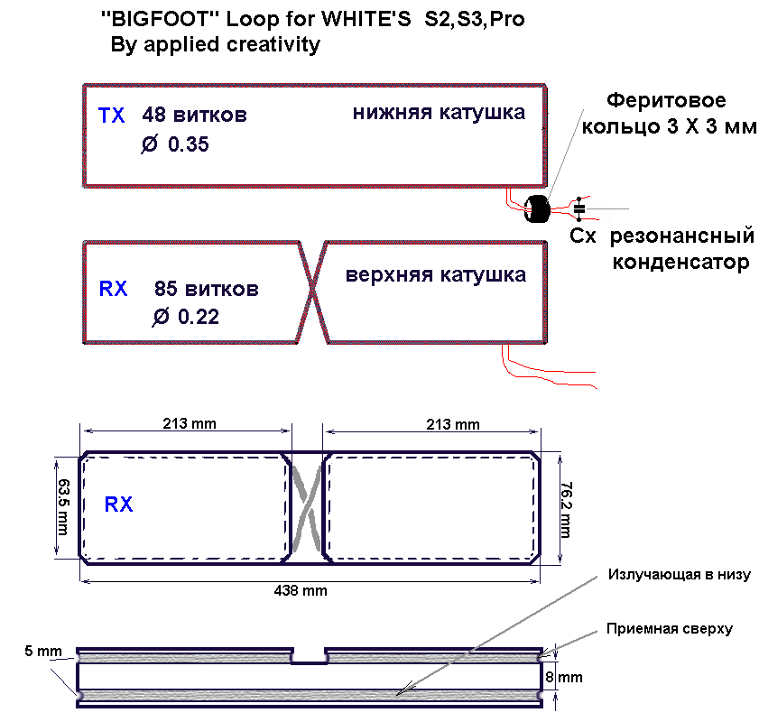

                pic of ciklon alias, from his site.

                    Thanks that's a great link kt315
                    Any chance of a translation please it's hard as it's a photo not text
                      What about the caps? I saw several discrete components between tx and rx coils of standard XLT coil. What's going on there?
                        thinking there are caps and resistor in RX. that is standart way for whites. nothing of whites patents gives full schematic of their coils btw. some kinda know how.

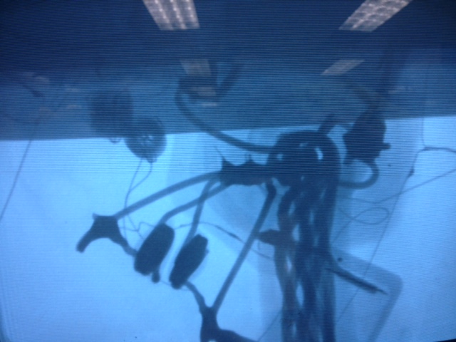

                        anybody has to put the coil under X-ray, then there will be clear pic.

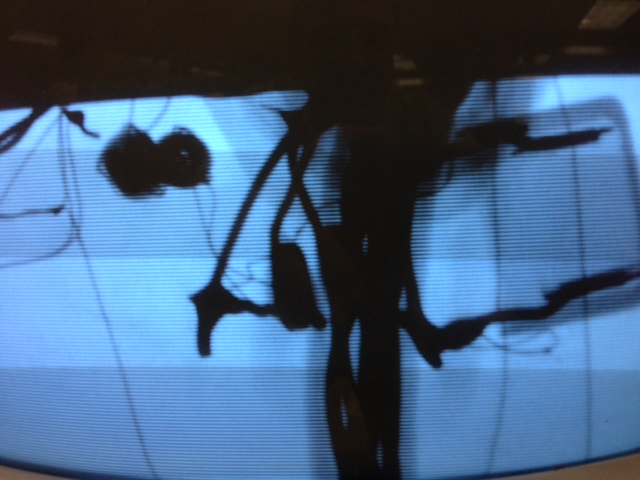

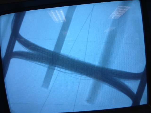

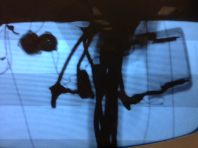

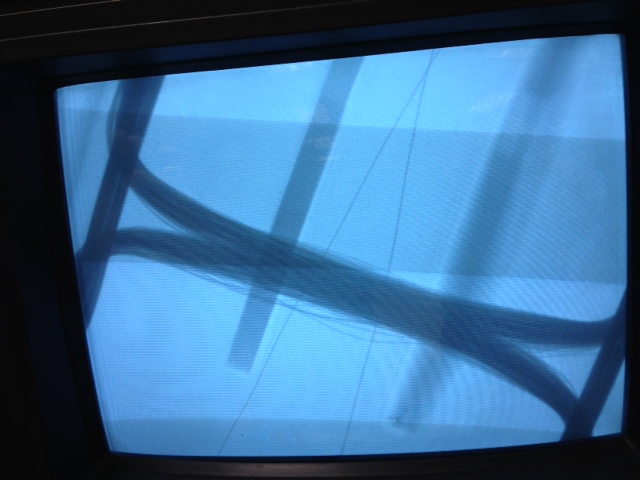

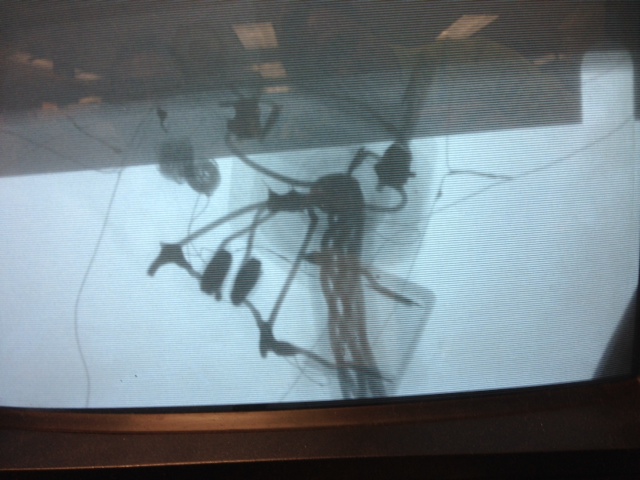

                          I just bought a Bigfoot off Craigslist for my XLT. Perhaps I can get it xray'd at work.
                            kt315: Thank You for the wiring and other info!
                            bklein: What a great idea - getting the bigfoot x-rayed ... Can't wait to see the pics, hope you can get it done at work ...
                              bigfoot xrays

ID:	340999Ok I got a guy to xray the coil.
                              Looks like it has variable caps, trimpots, or both along with discrete caps and some bizarre wiring....
                                Thanks for posting.
