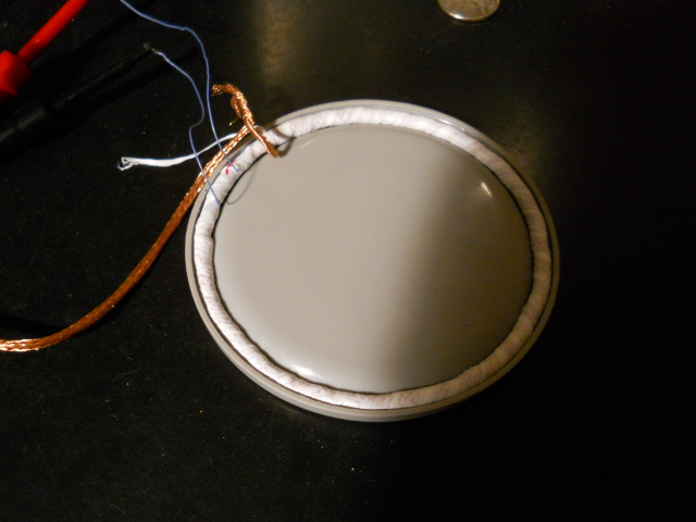

                  As far as shielding goes Im no expert but ive seen both foil and the scotch tape recomended in the same manner .
                  Cutting the foil into a strip like tape then wraping leaving the gap where the lead wire enter. Ive actually wound a coil inside of a copper mesh but i had to compress the windings too tight. But the shielding was or seemed wonderful..Click image for larger version
