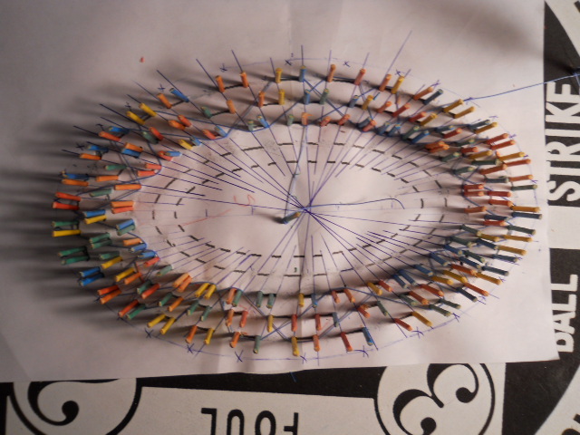

              • #52
                Forming a coil in this manner is not that difficult. What would be difficult is balancing it.
                matter of fact is fairly simple using a paper dart board you can form one coil on top of the other. What would make it complicated is me beacuse i always over complicate things.
                What I would do if Im seeing that coil correct is take your calculated wire, spool it to the center onto another spool and start with the rectangular coil wraping from the center of the wire successively alternating spools per wrap. wrap desired wraps set up tooth picks for figure eight coil stack. And if this is not actually the way the coil is wrapped the coils could still be seperated if you did it right. maybe a layer of paper between them tell testing is completed.
                Here is the dart board with a form set up.

                          • #58
                            also looks like the coil progressed ito a verticle dod tye arrangement. In the pictures Im not seeing the *8* pattern, my guess is same benefit easier to balance though.
                            What do you guys think?
                            • #59
                              certainly '8' splitted in two coils. but connected they in 8 pattern. so here all ok. also there are balanced turns, in both parts.
