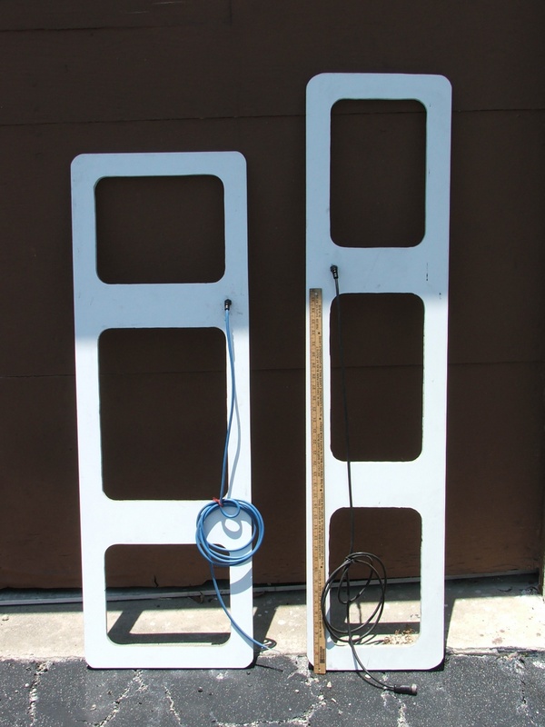

    See attached photos of some rectangle coils I made for shipwreck recovery. Wide search pattern
    yet still sensitive to silver coins.

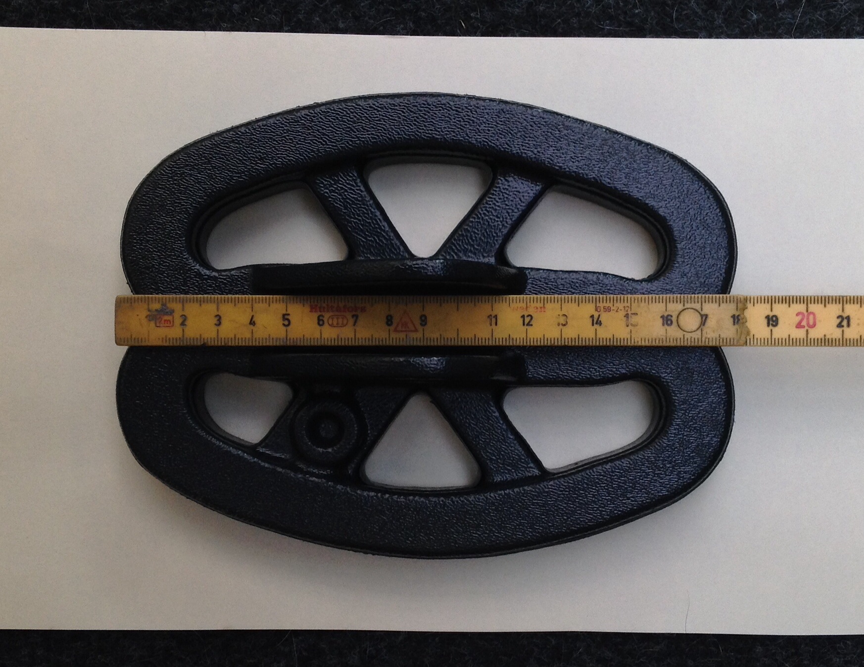

      If you had ask a DD coil small eliptical I would recommend you the DB Shell 5.5" x 7" (see picture).
      ps. First I didn't read the thread correctly, then I saw it was a mono coil you were asking, to late to Delete this. So I had edit some.
      forgive me.
      Henrik.

        Thanks for your reply and pictures. It looks like the coil you show on the left is the L/3 coil and the one on the right is a L/4 coil. Does the L/3 coil have greater depth?
        Dan
