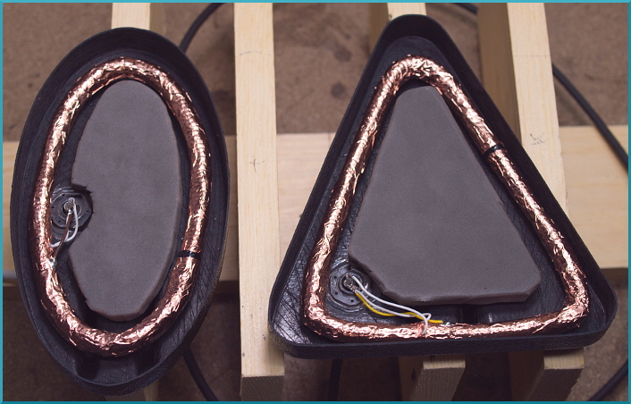

                          I doubt you will be able to make the 4 corners anything but rounded
Name:	foam coil1.jpg
                            [ATTACH]30167[/ATTACH]
                            Agreed…even with unnecessarily crimping the corners there is always some minimum attainable bending radius. From a practical point of view the question seems to be 'what effect does a 1cm radius corner have on the coil performance'? Another question is 'what is the effect just having a semi-circle or large radius on each end of the coil'? Hopefully we can get answers to these questions.
