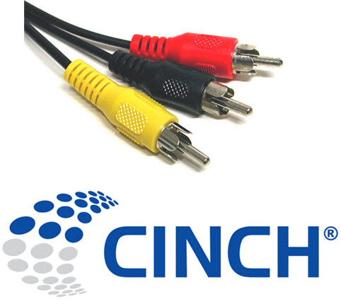

    The connector will be a low quality audio connector, see picture. Are they good enough? Thanks...

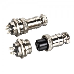

      I don't think that a RCA type is suitable for a PI detector. Beside other considerations ,these connectors are for signal transmission, not power.
      Usually, the hobbyists use this type
      Also, the core of the coaxial cable must be a multi strand type and not solid.

        If you can get it RG62-B/U is only 13.5 pf per foot and is far less capacitance than either RG58 or RG59 coax. No matter what targets you search for the lowest capacitance feed line is always the better choice in my opinion. I have been using RG59 BNC connectors for my PI mono coils and I know other connectors such as type 'N' are rated for higher power but I have seen no evidence of a problem with the BNC connectors in this application. I now use only twisted pair continuation of my PTFE (Teflon) insulated coil wire as a feed line and it is about 12 pf per foot (dependent on wire gauge)and I see no problems with type of feed either. Doing it this way eliminates all solder in the coil and the possibility that a solder joint might be detected at short sample times.
