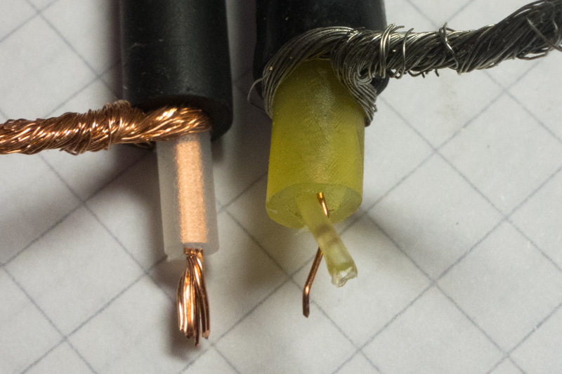

--------Originally posted by joop View PostHere's the picture: [ATTACH]30838[/ATTACH]
Left is RG58, right is the 150 Ohm cable. You can see a small spiral PE wire sticking out with keeps the center conductor in place.
yes I see the microphone cable looks smaller and has a stranded center conductor.I measured my microphone cable today and it comes out at about 50pf per meter, ok but not great.
