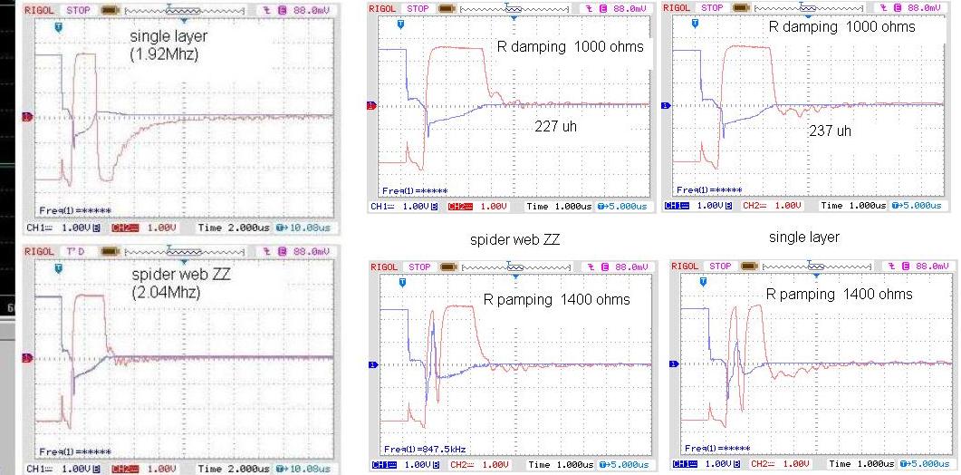

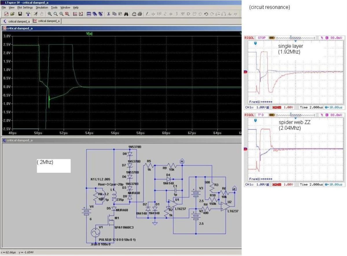

      Made a single layer vertical 3-1 to match 3-1 spider web ZZ. 22 turns about 230 uh. Both have a circuit resonance around 2 Mhz with R damping removed (not shielded). Got some overshoot with the vertical coil shielded, so I removed the shield from both. Used 1k for R damping (R5) with the bench circuit and LT spice. With Lt spice the circuit critical damps with 1470 ohms. I've thought I found why the overshoot before but it keeps showing up. The zeners were added in LT spice so the circuit would clamp the same as IRF740 in the bench circuit. Any idea why two coils with about the same specs would act so much different?
        Hi Green, Is it possible that the inductance/coil capacitance ratios are different? The same resonance frequencies achieved by different ratios might require different value damping resistors. The 1k damping value may be too high for either coil. I normally use a pot and adjust for the best wave shape. Most always the best value is less than 1k.
          Still trying to understand why the overshoot. The single layer winding is sandwiched between two pieces cut from a cardboard box.Tried wrapping the spiderweb ZZ coil with a layer of of the cardboard box to see if that would make a difference. Not. Reran the coils with 1000 and 1400 ohm damping resistors. The first two scope traces are from the other day at 2 usec/div. The other traces at 1 usec/div are from today. The single layer coil overshoot is a lot less today.
            Hi Green, it still looks like they need a lower damping resistance, suggest 500 ohms. Also looks like the op-amp front end is staying in saturation too long; might try less gain or increase the op-amp +/_ power voltages from +5v and -5v to +12v and -12v or 15v. This may require changing some of the capacitors to a higher voltage rating.

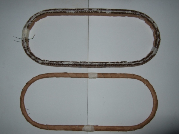

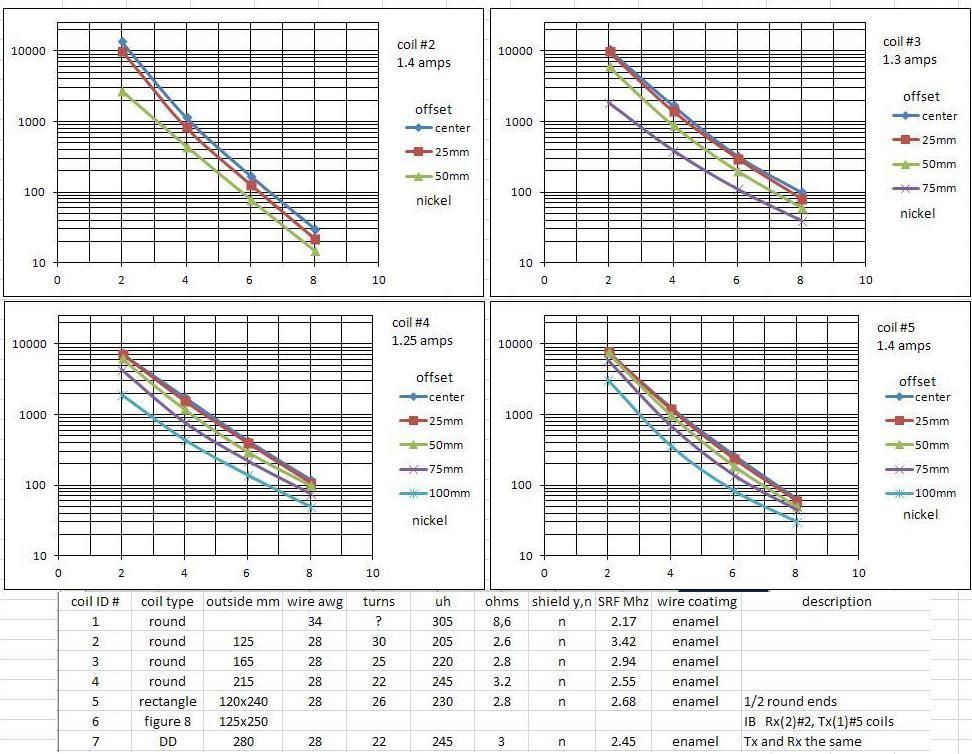

                  Made more spiderweb coils. Want to make a figure 8 coil. Thinking of using two round coils for the Rx and a rectangle coil with 1/2 round ends for the Tx.Tested the coils without a shield to compare the coils before making the figure 8. Something to compare the DD and figure 8 against.

                    Looks like the 8" coil #4 has the best sensitivity at 8".

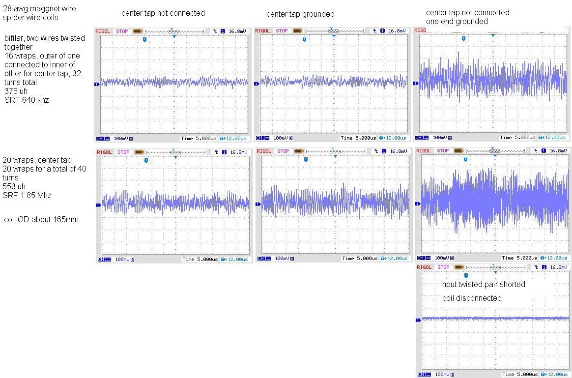

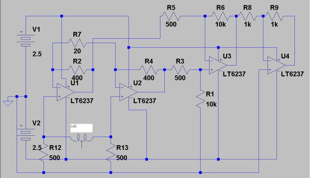

                      Made a couple center tapped coils, one bifilar, one not. Wanted to compare noise rejection to start with. Don't know what to expect. Grounding center tap didn't help. Differential input better than single ended. Both coils more turns than needed. Bifilar less noise but lower resonance frequency. Shorted input less noise. Neither coil shielded yet. Damping resistors R12 and R13 would need to be changed for critical damping. Could someone tell me if it is what I should expect or what I might be doing wrong. A lot of the noise is high frequency due to using higher frequency amps than probably needed. Spelled magnet wrong. Both coils similar size, about 165 mm diameter
                      • #41
                        Going differential and centre tapped should result in 3dB more noise compared to single ended if you keep all other parameters the same. However, keeping the same number of bifilar turns provides you with double the signal or 6dB gain, or 3dB overall gain (6dB - 3dB).
                        In this particular case I think there might be some problem with extremely fast op amps. You could try adding ferrite beads at non-inverting inputs (as gate protectors), and perhaps some small caps in feedback branches. Point is that a coil is also an antenna. Even when you shield it, it will still be antenna of the same aperture.

                          Very interesting results, especially the differences in self-resonant frequencies. Is the MOSFET driving the entire coil or just one half of the windings?
                          The noise will probably be greatly reduced in the field away from manmade electrical noise.

                            The coil is just connected to amplifier in reply #40. Was looking for noise comparison. Don't have bipolar driver built yet.

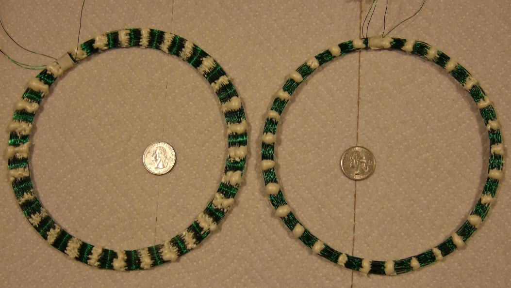

                              Thank you for the reply and pictures. Nice coils. Can you explain why the coil with more turns has a higher self-resonant frequency?

                                I'm going to guess it's because the coil with fewer turns is bifilar. Starts out with two wires twisted together and then wound, then connected tin series. More capacitance than the other coil where each turn just sees the turn before and after. To me it looks like a spiral coil wound spiderweb. I expected more capacitance with the bifilar coil, but wondered how much less noise it would have. I couldn't see any advantage other than noise. Maybe there is?
