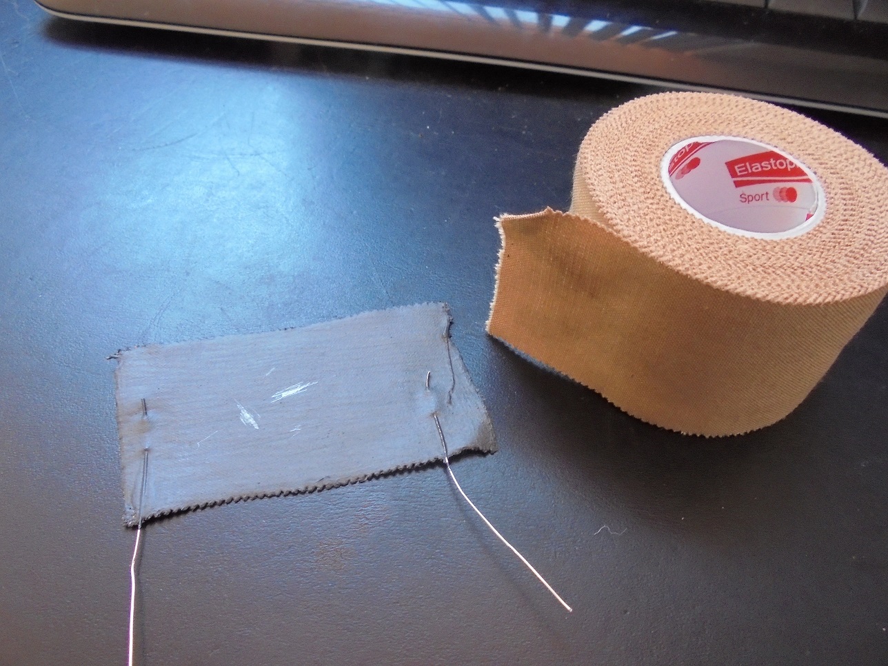

                    Well seeing as I am impatient, I thought I would experiment with what I had on hand and I think I may have a good combination.
                    I used a mix of graphite powder and a mortar bonding agent (you can get it from hardware stores) and thinned it down with a bit of water. I brushed it on to some sports strapping tape and now have a flexible, conductive piece of tape.
                    Conductivity between the 2 wires - 60mm apart - is approx 1k (thats only 1 coat - more coats may reduce that resistance if needed)
                    I will wrap the coil and then brush the graphite coating on. As the mortar bond and tape remain flexible hopefully the shielding shouldnt suffer cracking. it seems to be pretty abrasion resistant too. The small shiny marks are where I tried to scratch it with sharp probe points.

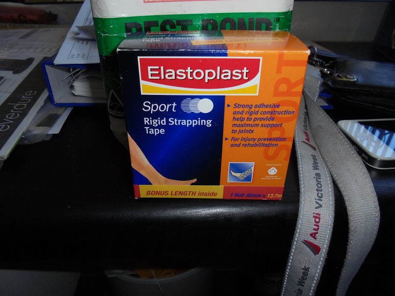

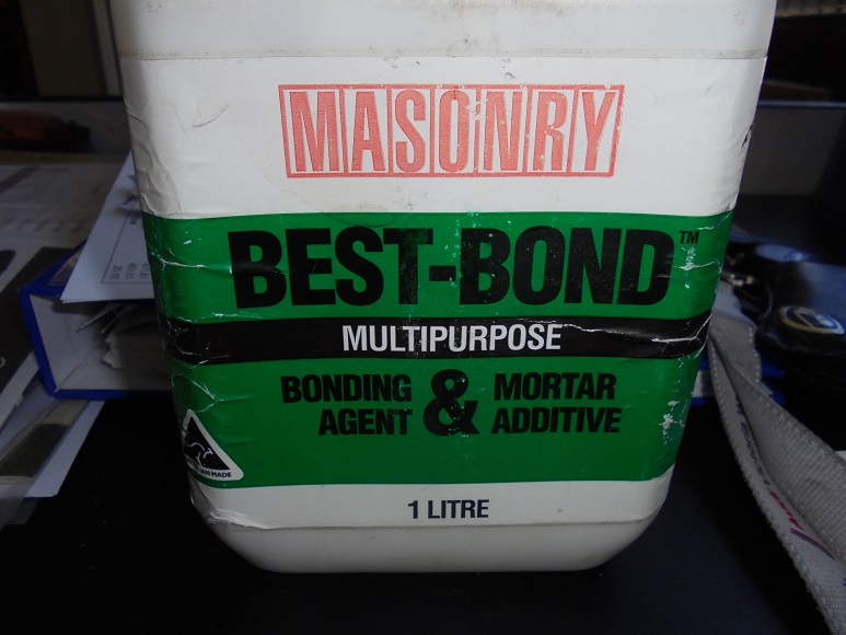

                      Cas would you mind telling us the name of the mortar bonding agent?
                      and was the tape Elastoplast Sport Elastic Adhesive Bandage 50mmX3m Roll

                        I use the sports tape because it has a stronger adhesion than others I have found while being porous enough to hold the graphite mixture (plus its what I had at the workshop).

                            The mortar bonding agent is just PVA i.e. Elmers white glue.
                              I have tried PVA and graphite but never had any luck.
