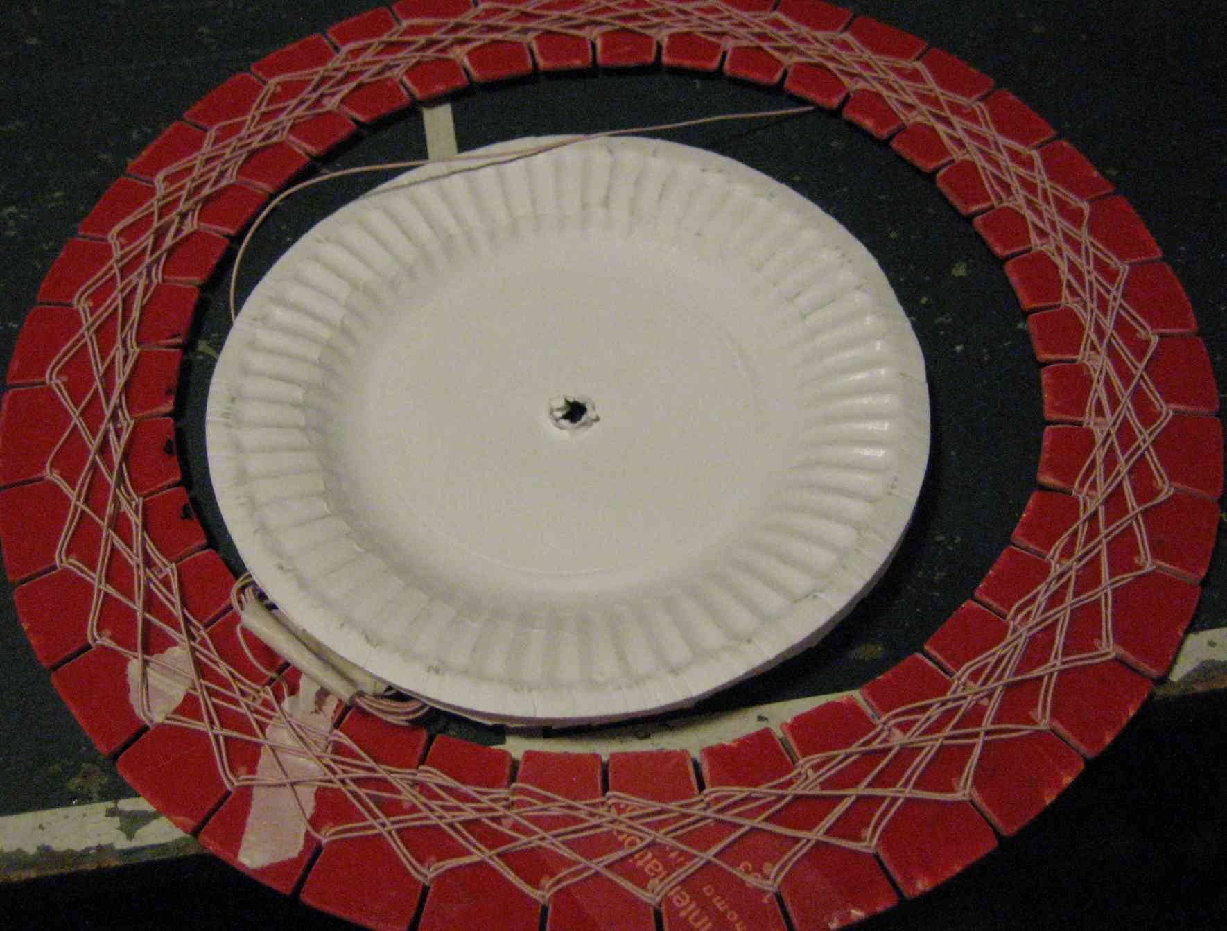

    Well you probably built yourself an incredibly slow coil. I've built a fair number and some work
    quite well (though I do not have a working PI detector yet). I've found the inter-winding
    capacitance will slow your coil way down. If you use magnet wire you need to at least wind
    it basket style to keep the windings away from each other. Like this;
    http://www.geotech1.com/forums/attac...1&d=1414104068
    Better would be teflon coated stranded wire or basket wound litz. If you have a scope you
    can see how slow it is by monitoring the First op amp output.

        Well "enameled copper wire" is magnet wire. The wire with some kind of plastic coating is the other kind.
        The plastic coating spaces the center conductor away from adjacent wires reducing capacitance. The same
        thing happens with the basket coils the air gap reduces capacitance. Capacitance slows down the falling
        edge of the transmit pulse. We need to wait for the transmit pulse to be done before sampling. Small gold
        decays rapidly. So a coil that has too much capacitance will miss small gold as you cannot look for it until
        the transmit is done decaying.
        A PI detector will work with most any coil but a slow coil will filter out some targets. If you set it to see
        big/deep targets it will also not see small/shallow targets. The first limit is how fast it is (IE how soon
        can you sample and see a target?). The next limit is how much power is being sent out?
        Once you have a fast coil with a lot of power you then adjust it to see the size/type of material/depth
        object you are looking for.

                        try basket coil http://metdet.ru/Sensor_K1.htm but add inside second winding so there will be a hybrid - Double Field Backet coil
                          For such big and small windings spaced coil housing, you need to use Cu enameled wire >0.5mm in diameter. Nothing like Teflon or PU isolated cable will suit in such housing (it is primarily intended for VLF/IB coils). For lower inner parasitic capacitance you can wind it in some sort of zig-zag manner.
                            yes, he needs maybe to use the litz wire.
